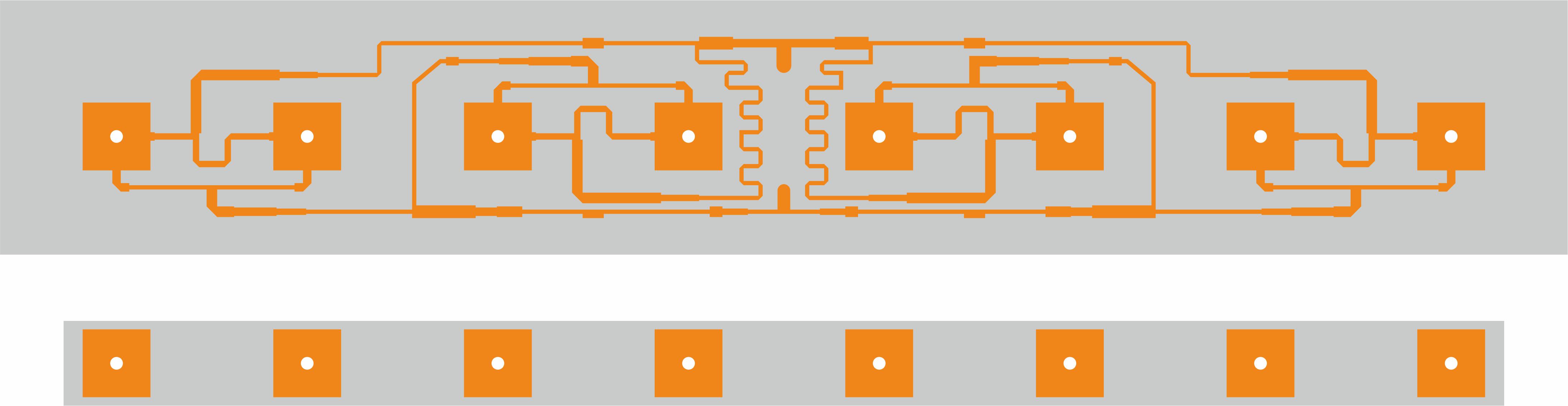

" yes, 3 antennas spaced at 56mm and get this gain in directivity...
i made this antenna and it didnt work well :(
i use mikrotik rb433 with wireless card ubiquity xr5 One chain
signal not good i tried it to 2 km   i got  -77      i tried my own original sector i got -54   and i tried my own sector copied from original i got -59
On 11/8/2018 at 9:39 AM, Admin said:
buddy, the antenna also has directors ,,, ??
which is the distance from the reflector?
what PCB does it have?
can i use only sma1 or sma2? not the both?
,,, what kind of antenna simulation program do you use ... ???

i dont use antenna simulator program i dont know
sir please reply to my questions :(
Just now, Admin said:
,,,, you have to use both ports ... !!!!
what will happen if i use one port ?
Edited by Everzone
,,, then why is this antenna built... ???
im just asking be cause i used one port
and im not getting good signal
if i used wireless card with two port it will work with little better signal ? or high increasing of signal? (DB)
,,,which are the basic data of your BS(Base Station)...???
On 27/10/2018 at 11:24 PM, DC13th said:
This is a duplicate of the antenna mimo 5Ghz 120°
The size is in accordance with the original
Who knows anyone needs or can modify it to make it better
