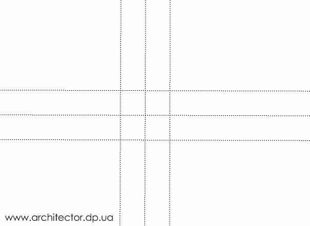

Last gif image is how to build an ellipse with line and compass....!!!

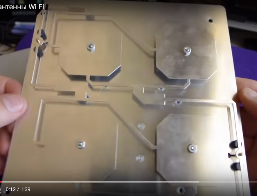

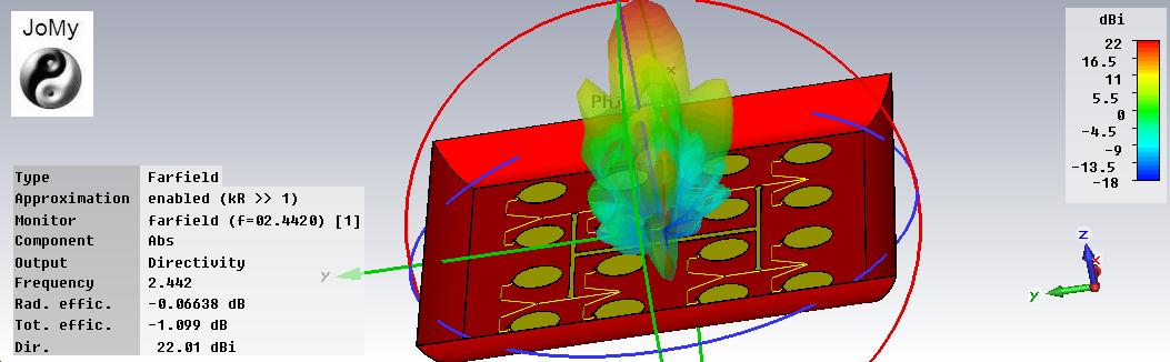

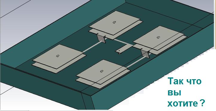

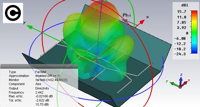

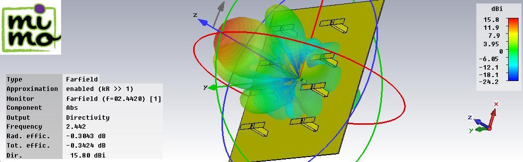

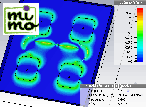

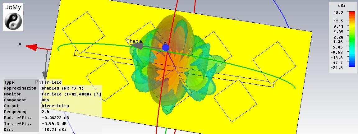

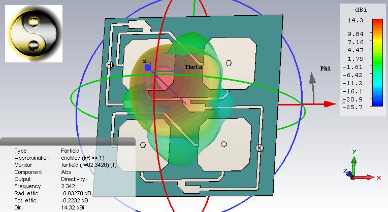

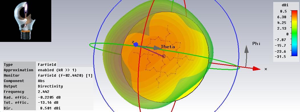

The last antenna can be converted to mimo 2300-2400MHz.
A drawing of this antenna is very necessary
is too complicated laser cutting....!!!!
My laser engineer says - his machine is wrong - / + 10 microns. If you teach the calibration of the machine for the desired part. Admin, striplines of what width?

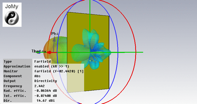

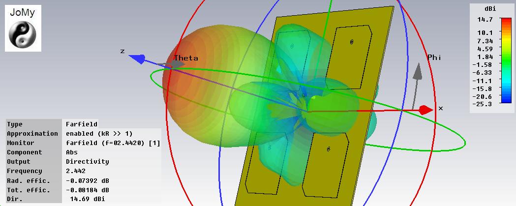

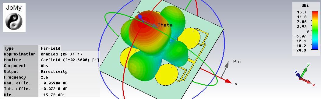

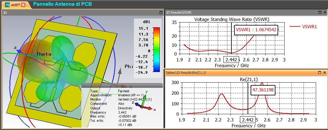

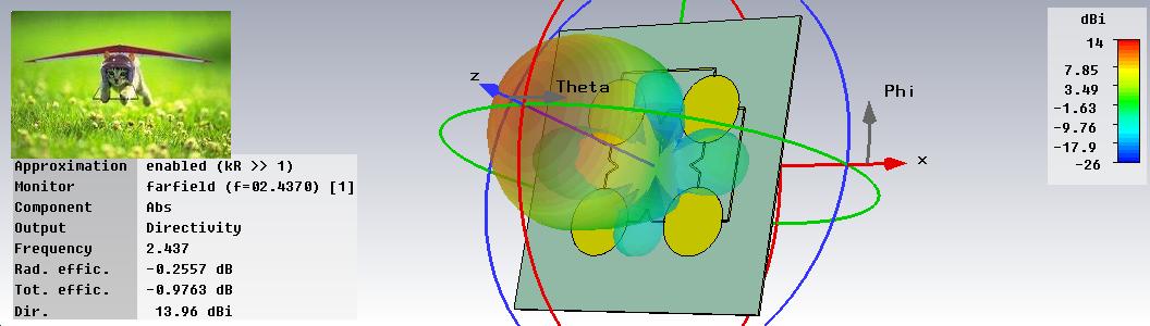

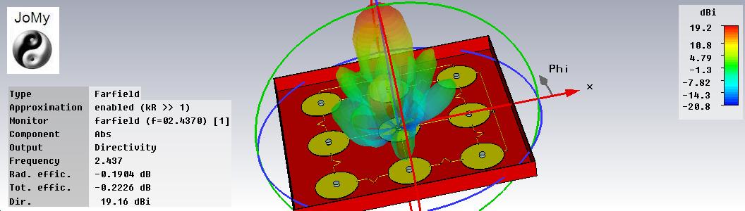

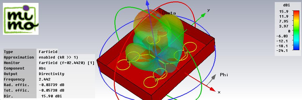

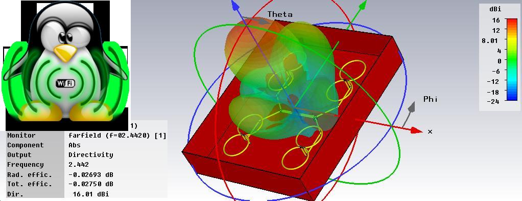

MiMo Panel Antenna 2,4 GHz

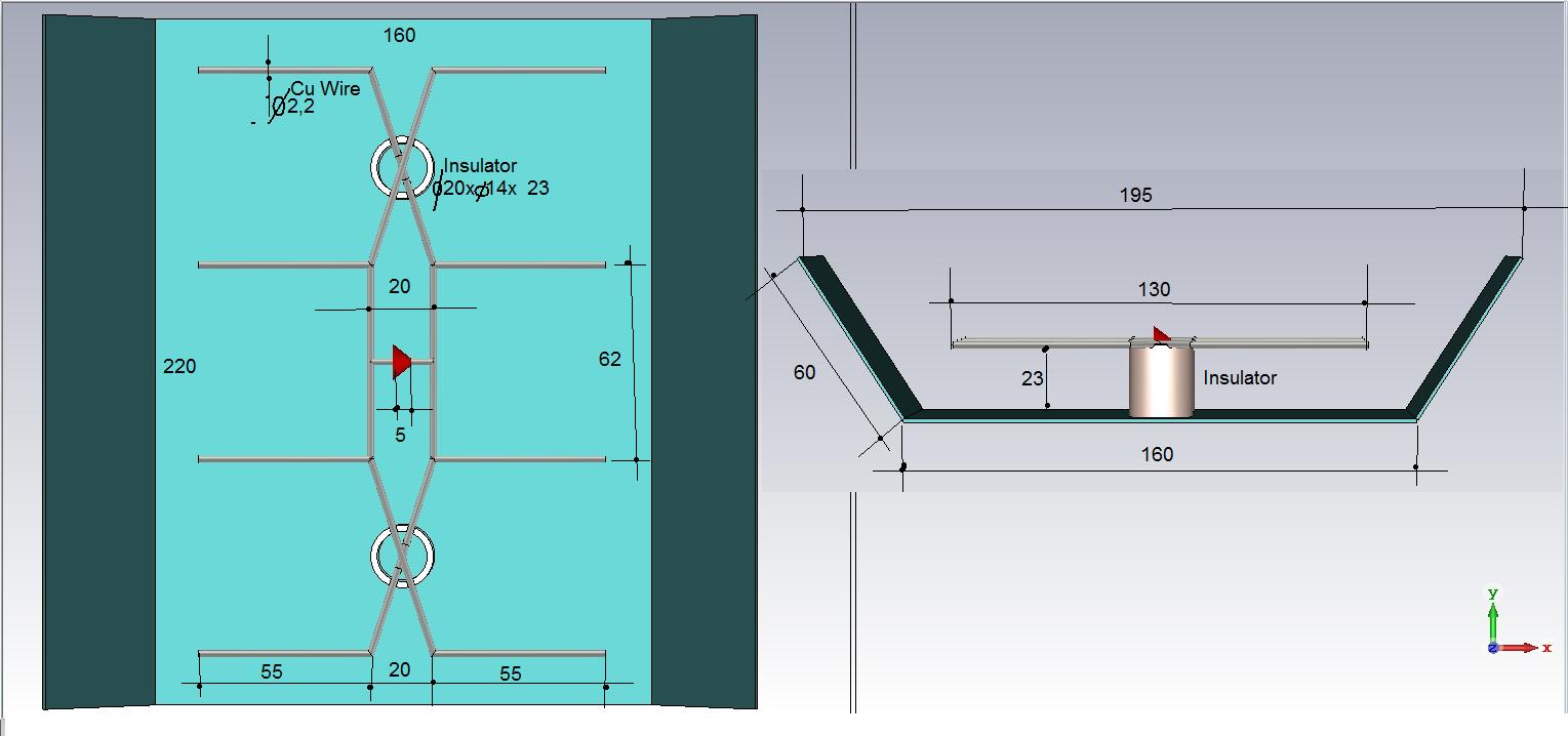

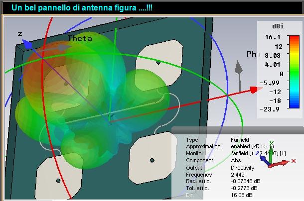

4Dipols Panel Antenna...

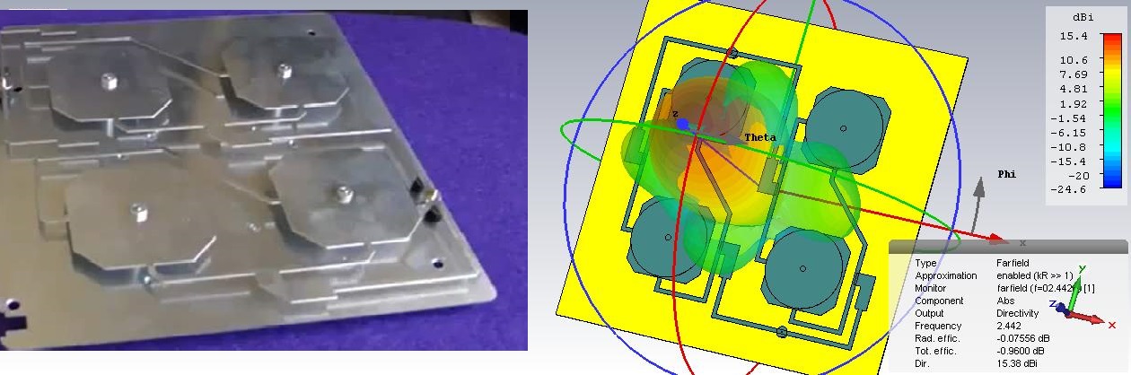

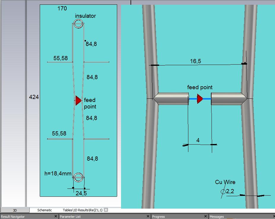

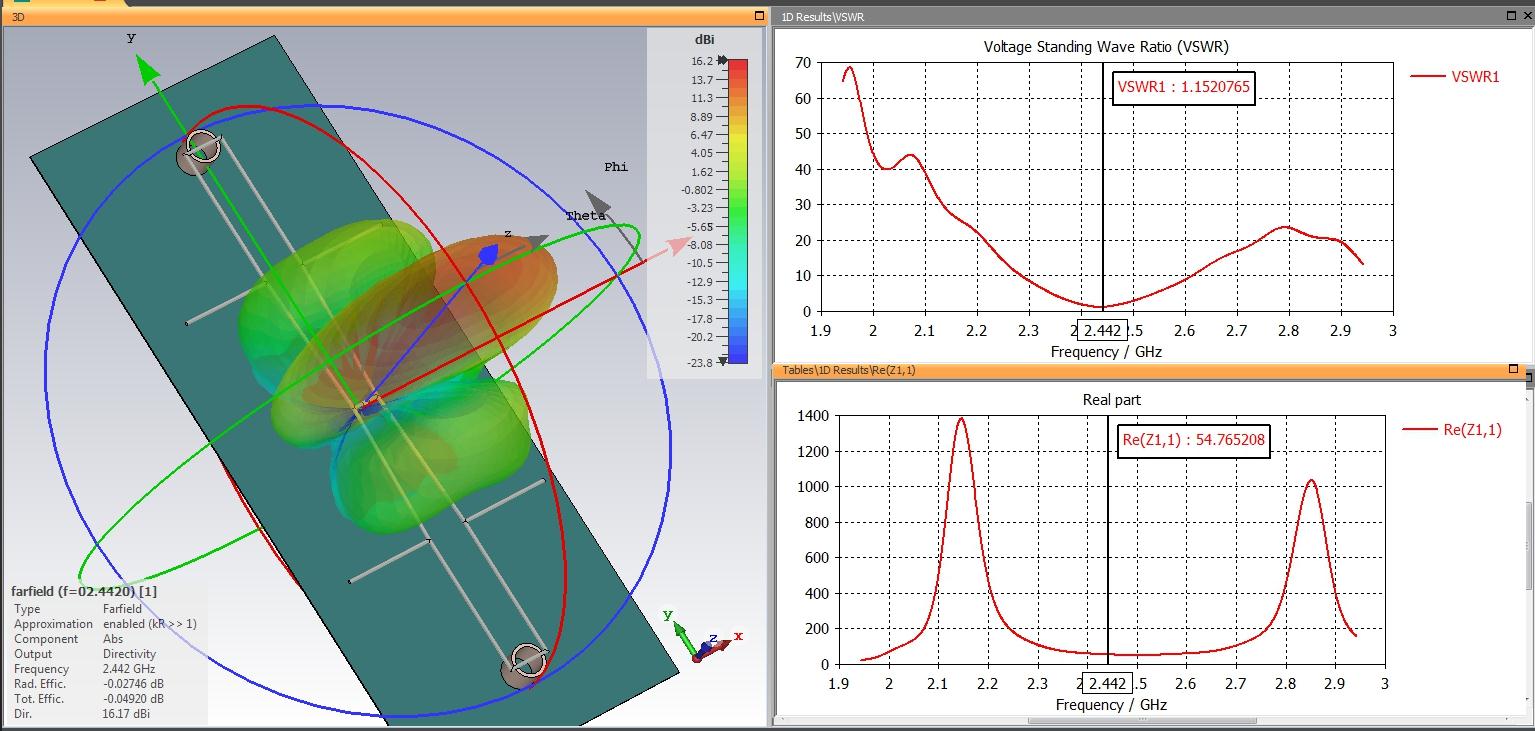

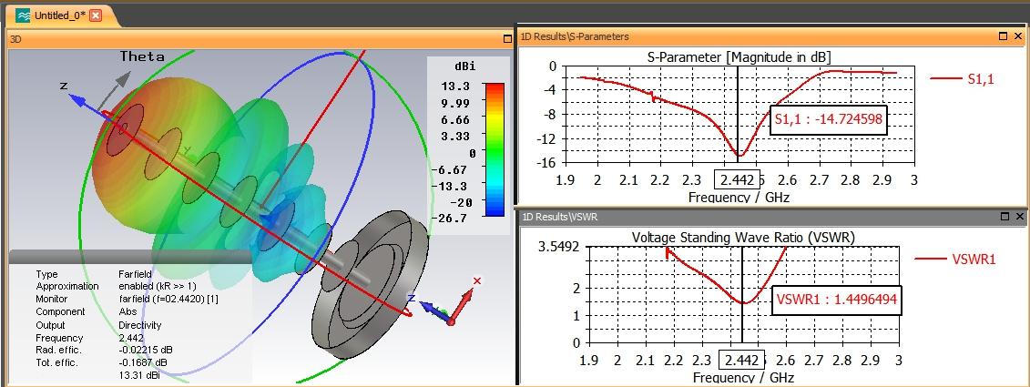

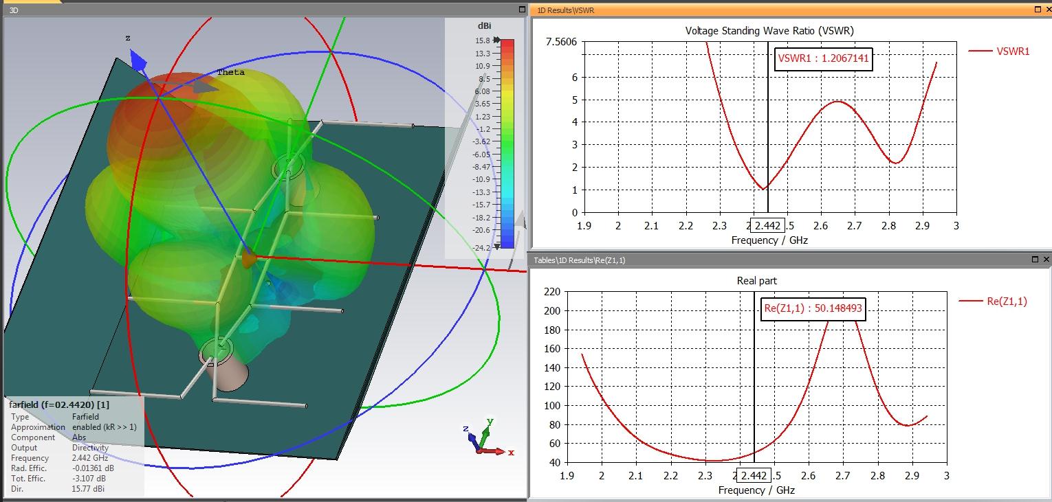

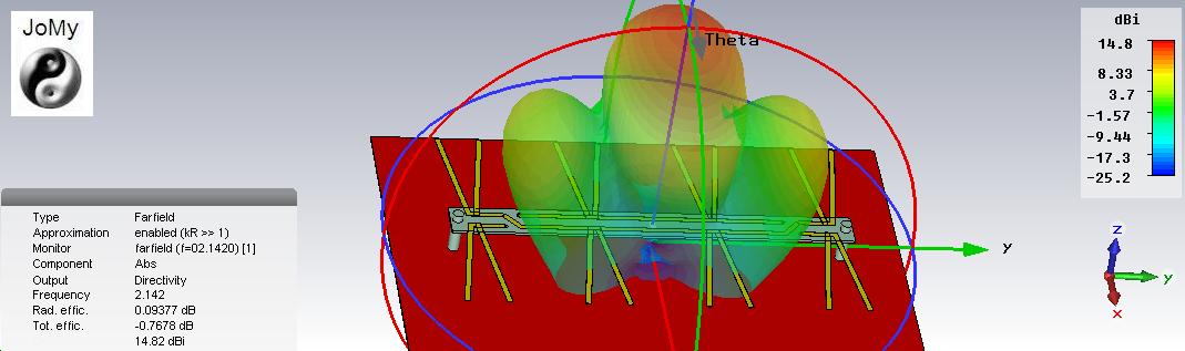

Hello.
Do you have the dimensions for this antenna?
 I do not remember ,,, but it can resume the simulation...!!!
38 minutes ago, Admin said:
ya, that's it...
Thank you.
Questions:
1. Should the size of the insulator be the same?
2. If remove the "sides" of the reflector - greatly change the gain antenna ?
3. If  take 2 mm wire? Greatly change the gain antenna?
4. Reflector - depth  size (1 mm)?
1. no matter the size
2. yes
3.yes, maybe 2,5mm Cu Wire
4. yes
...yes, I remember this antenna which is simplified Curtain and now i I have reviewed it... with other dimensions,,,,
