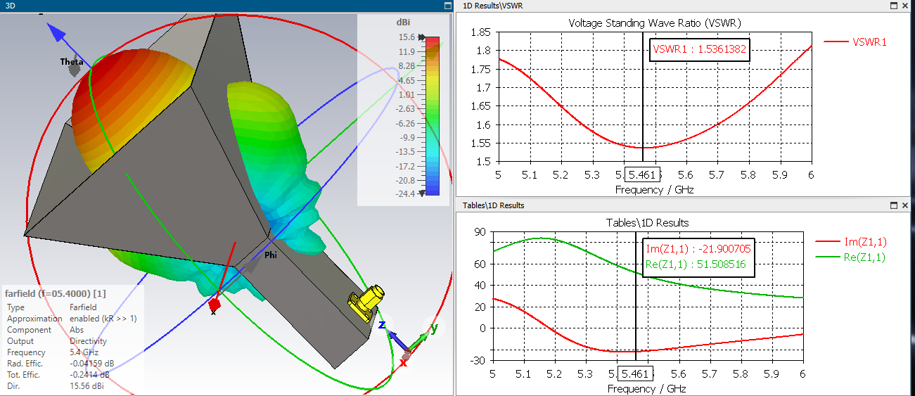

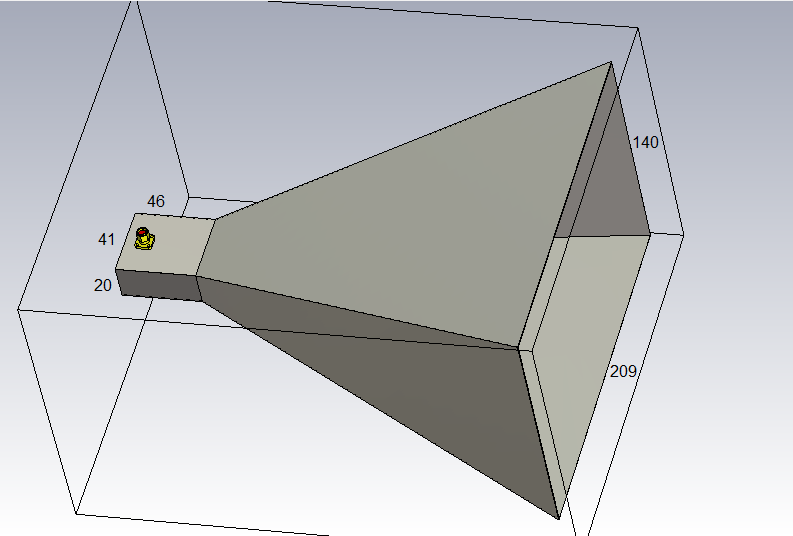

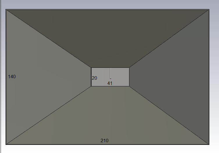

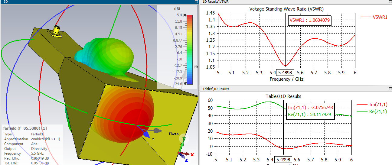

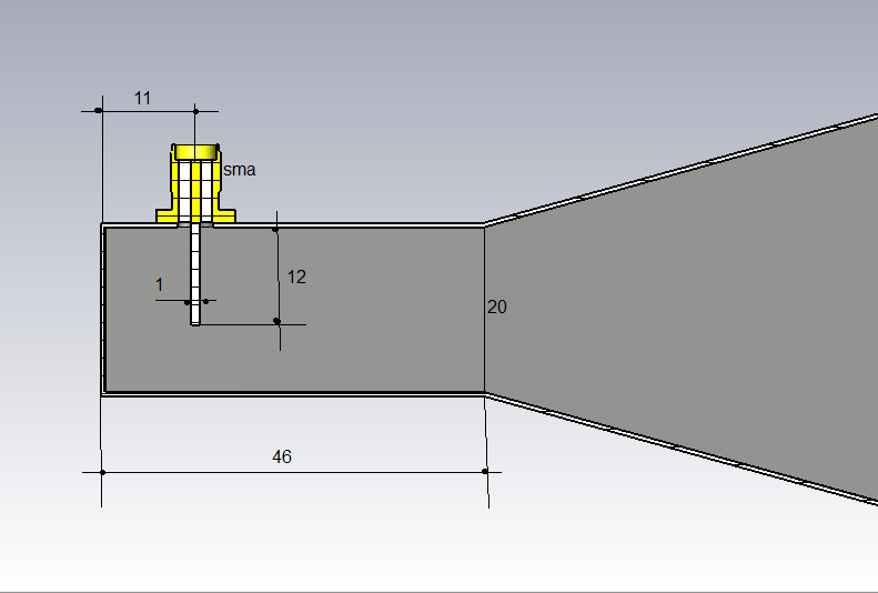

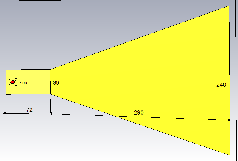

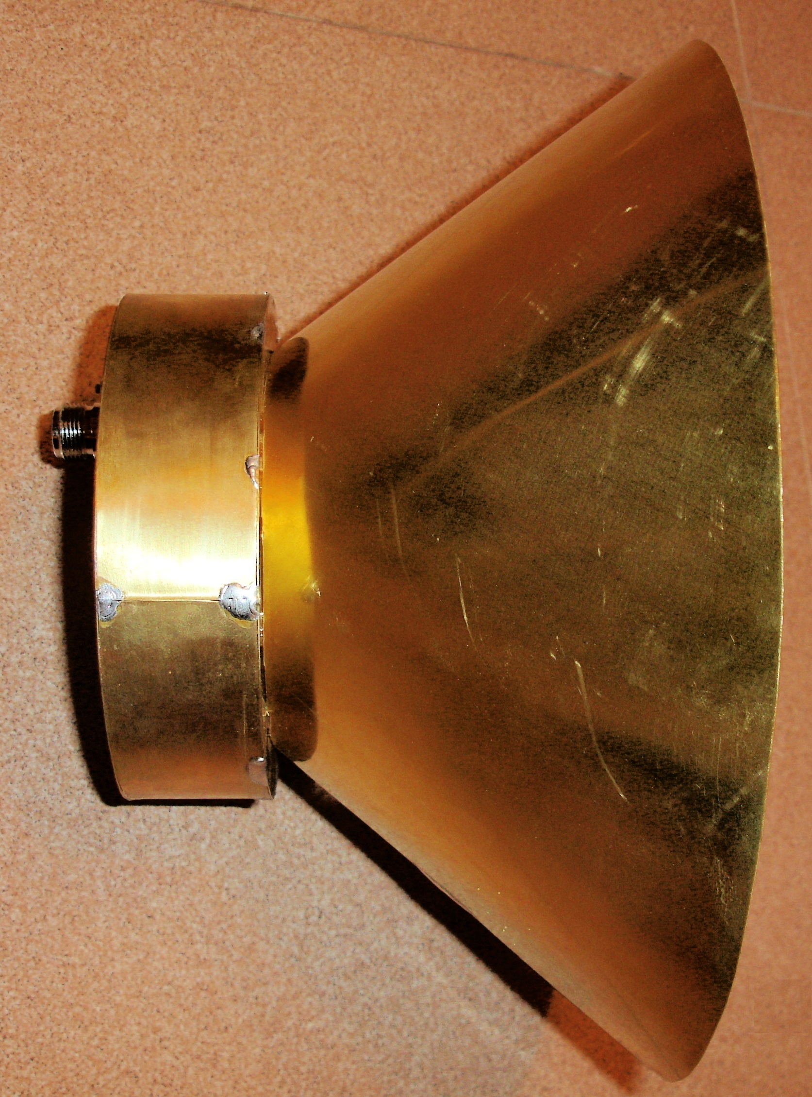

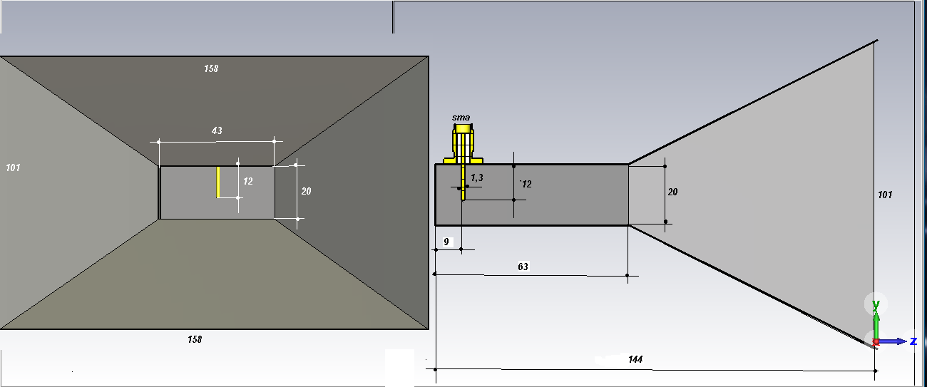

Hello everyone.Here are proven horns for offsets at 5.4 Ghz offset 60cm .
horn5,4ghz.cst

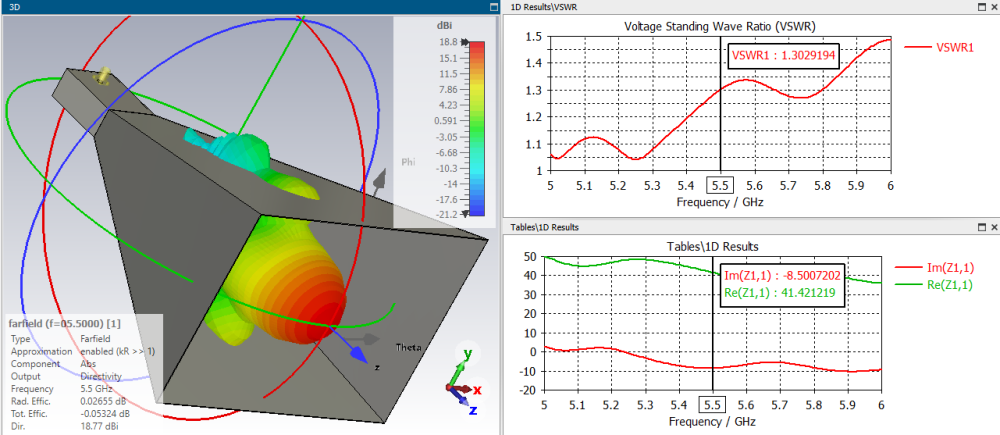

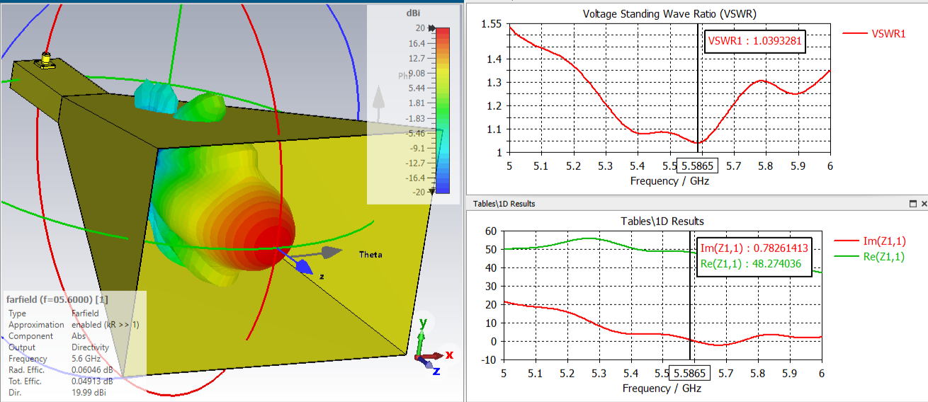

Monopoles are highly CAPACITIVE (too short) with the cone shape maybe gets closer to 0...reactance ?
horn5,4ghz.cst
