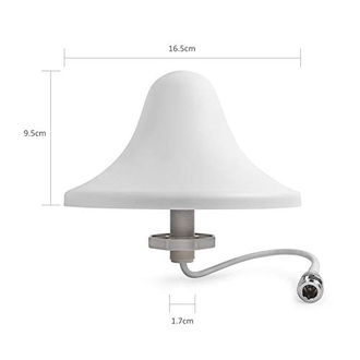

GSM RP-107 ANTENNA (800-2700 MHZ)
The antenna is used to connect to a repeater (amplifier) and is designed to amplify the GSM, 3G, LTE signal in offices, residential buildings and industrial premises, allowing you to get a stable stable signal for cell phones. The antenna has a wall mount that makes it easy to install and secure to the wall.

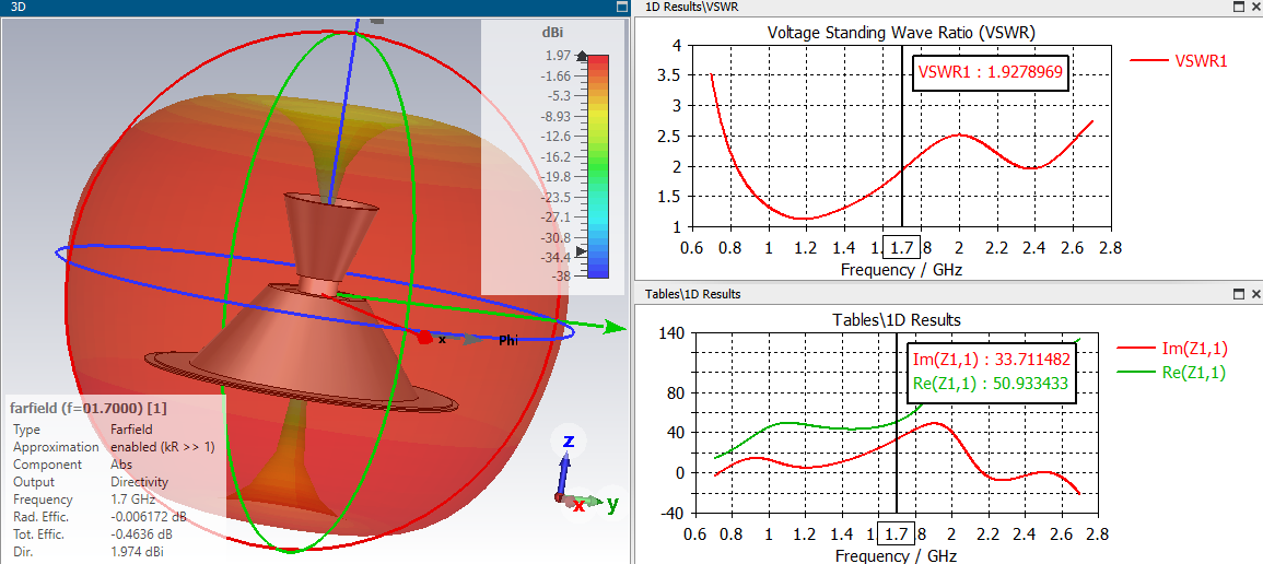

,,,but it seems that it is not what is said...!!!

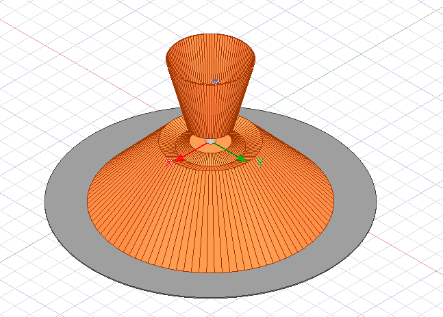

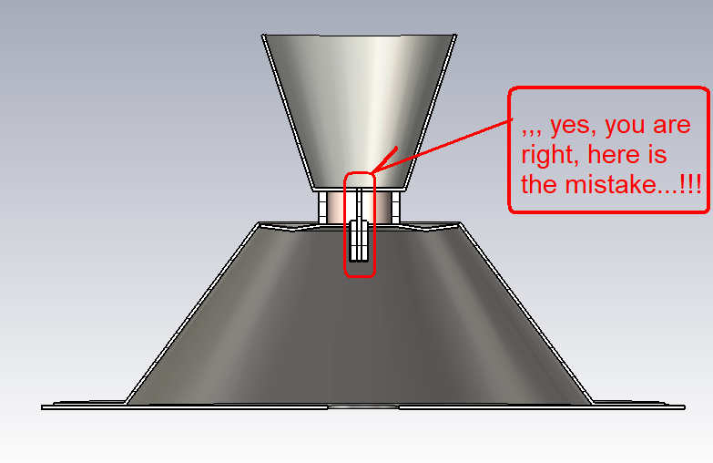

How does the FEED point looks...? it should be be wider band...

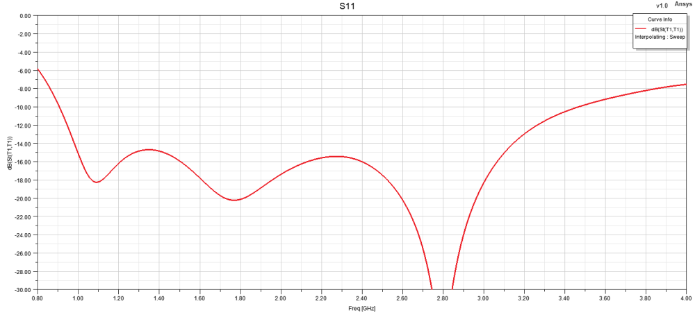

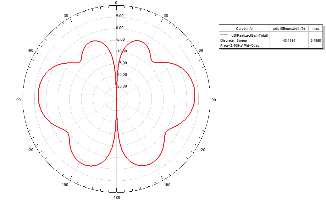

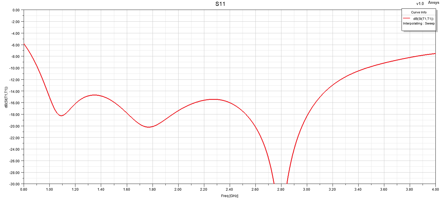

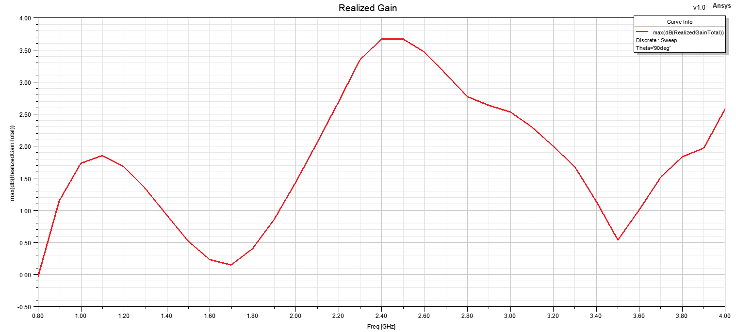

I also tried to simulate this antenna. I had return loss shows that this antenna can work between 800-2700MHz with little tuning but I couldn't get gain up to 5dBi
Only way I see to increase gain...is a reflector (Not omni anymore , but could add 3dbi (multiplying elements cuts down on bandwidth and impedance changes)
If you add a reflector is still omnidirectional. An omnidirectional antenna is an antenna that radiates or receives radio waves equally well in all directions within a specific plane, typically the horizontal (azimuthal) plane. This means it provides 360-degree coverage around the antenna in that plane. To be accurate, in the response it could add 3 dB. Not 3 dBi. But we understand.
