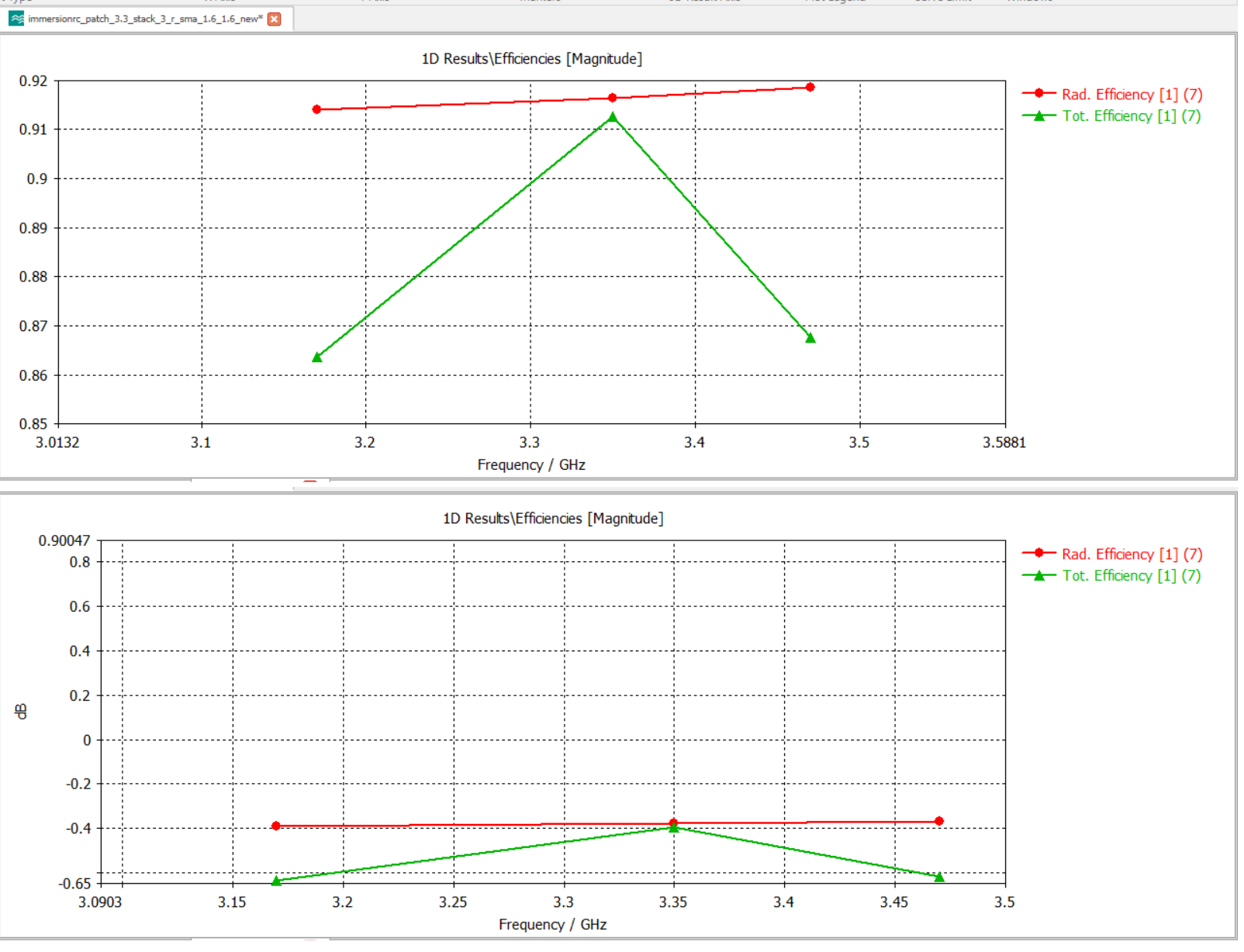

Check efficiency , usually is poor for FR4...(it hurt RX) , if you are close to 90% it's good enough...imho
Here are screenshots from cst. What do you think?

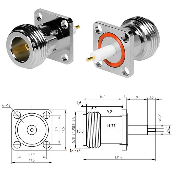

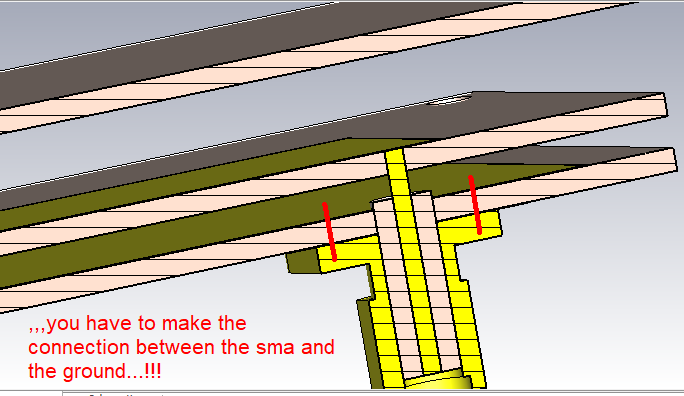

21 hours ago, Admin said:
naumoves,,,try this...
N-P245 mufa.cst

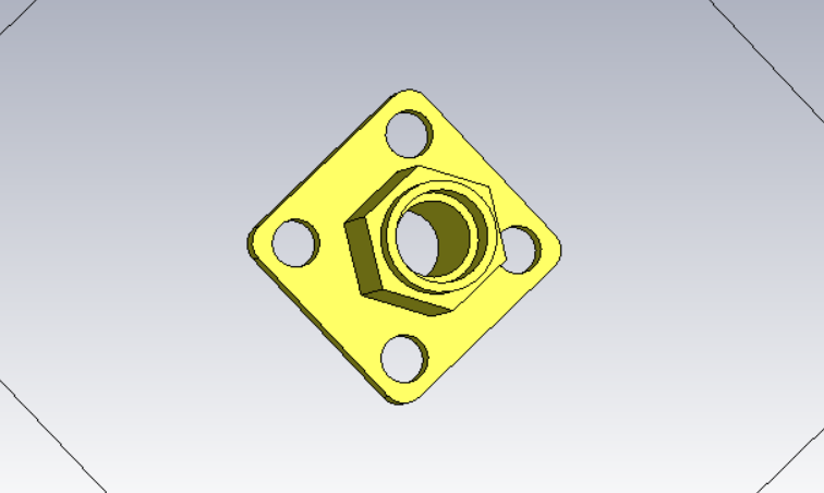

Thank you! I found your design and modified it a bit for different length of feeder and teflon plug. :)

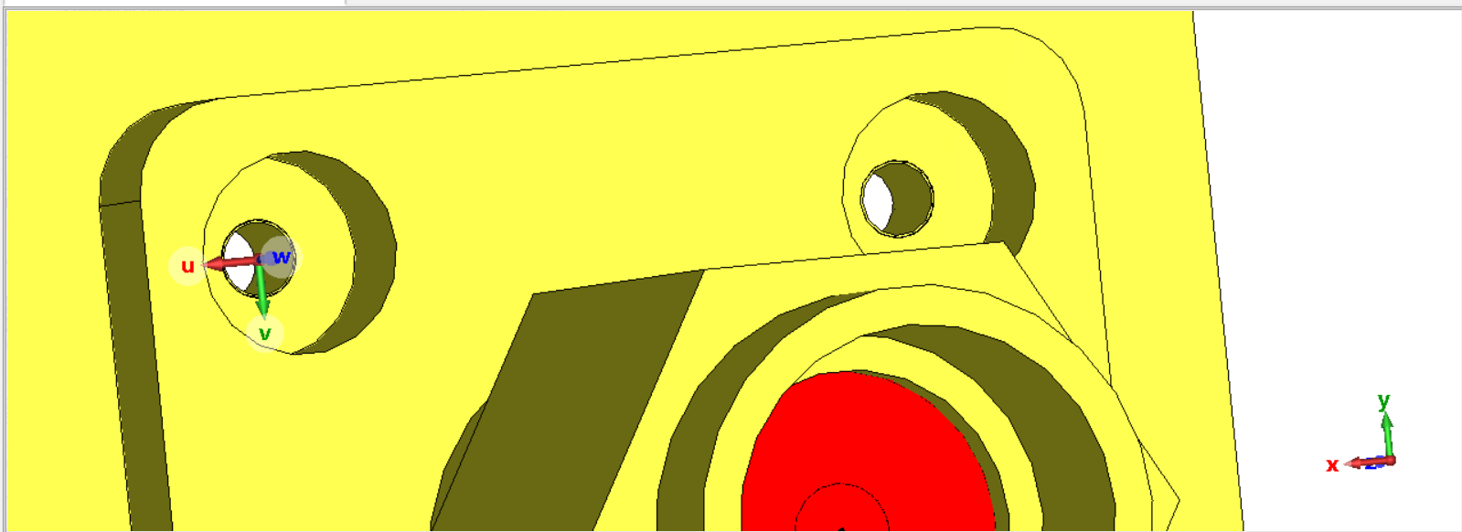

Yeah... You are right. Can i do it with via holes?
,,,yes...!!!

Will these via holes work?
,,,YES...send me the CST file...!!!
