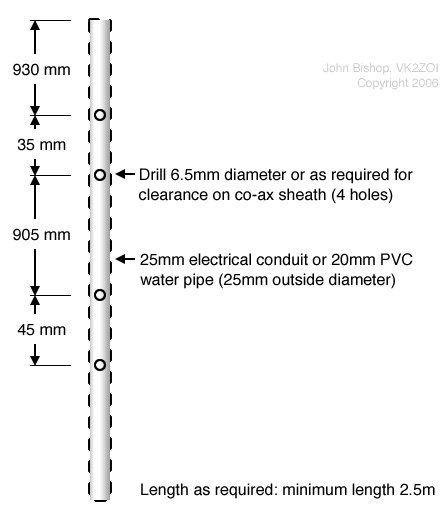

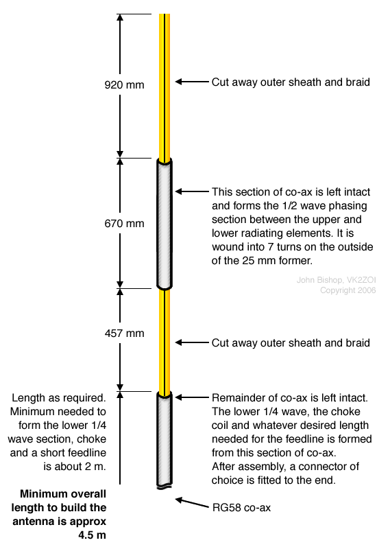

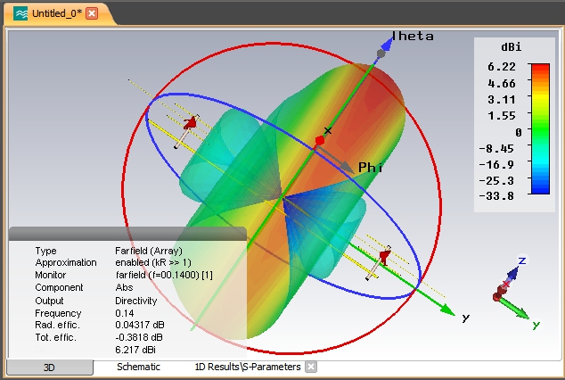

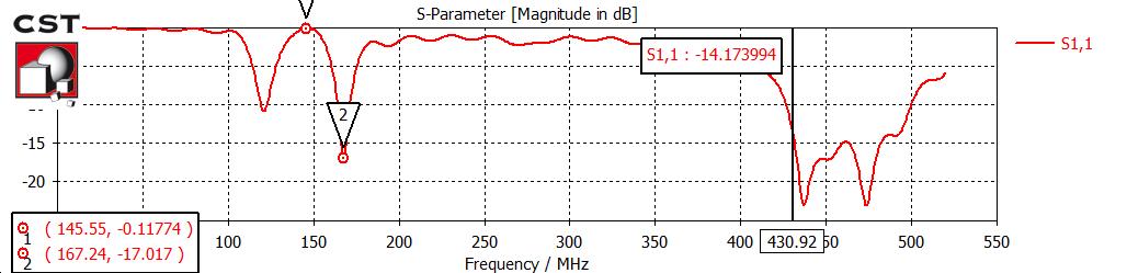

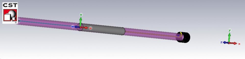

So gathered this antenna 145{144-146}+435{432-435} MHz type for rest. The model of the antenna

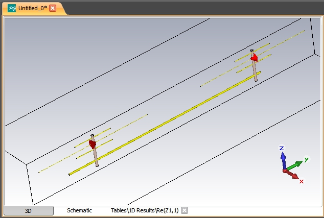

How would you simulate this antenna?
This is a collinear 144 + 430
Hi bro...!!!!
I think I need more constructive details...!!!

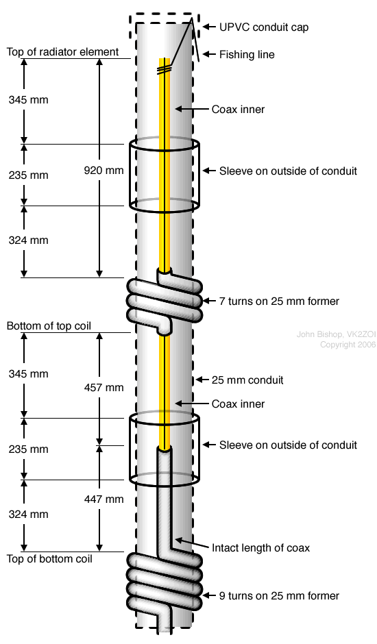

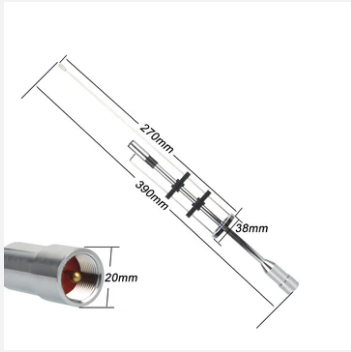

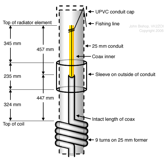

What kind of coaxial cable is used ... ???

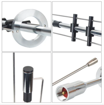

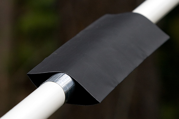

Sleeves,what material is it?
From where did you get this drawing...???

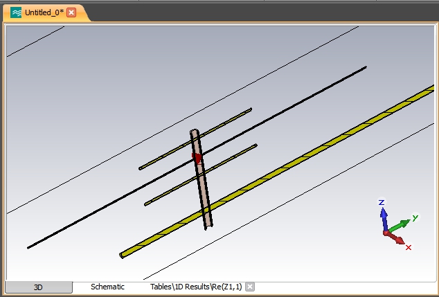

,,,you make the copper wire spiral and then you extrude the faces in succession(with different materials and thicknesses)...!!!
,,,but the antenna looks great at 2.5m...!!!

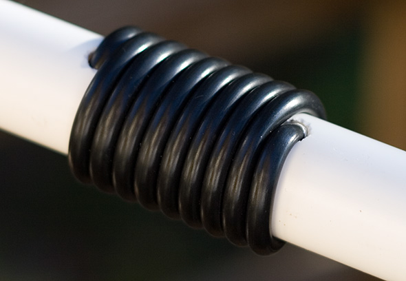

,,,aha,this it"s the sleeve flower pot, with UV protected PVC tape or heatshrink...!!!
,,,and the coils...
,,,the other...

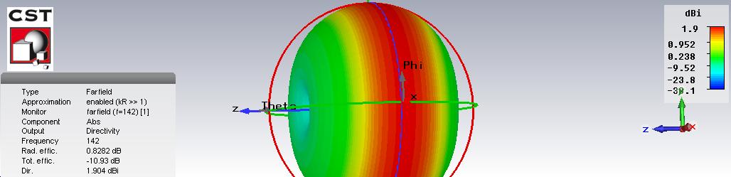

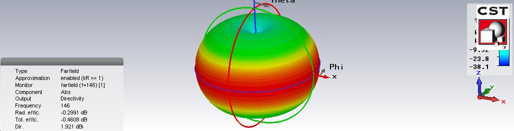

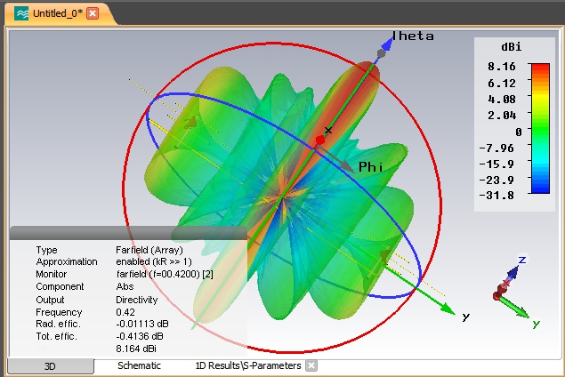

ook thanks,

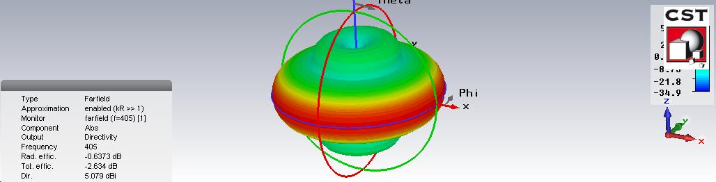

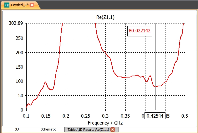

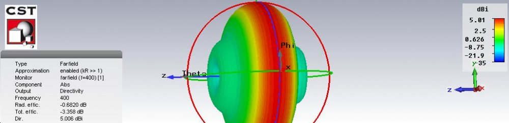

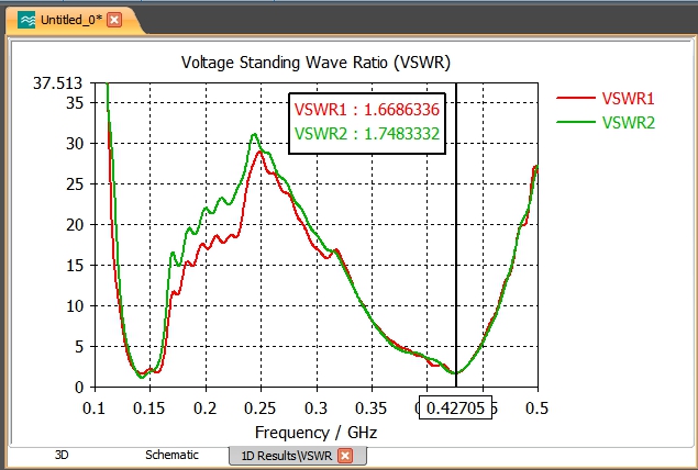

will CST simulate well a coaxial cable with transient analysis ?
In contrast to frequency domain tools, a transient solver’s performance can be degraded if the frequency range is chosen to be too small (the opposite is usually true for frequency domain solvers),,,,then  transient analysis ...!!!!
,,,good work, but it's still to work....!!!!

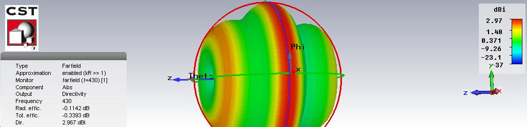

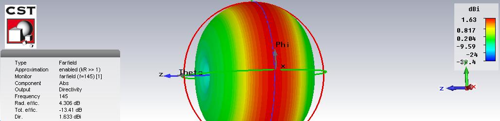

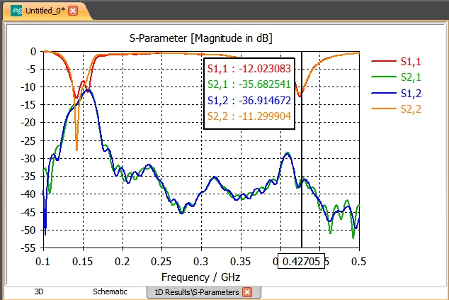

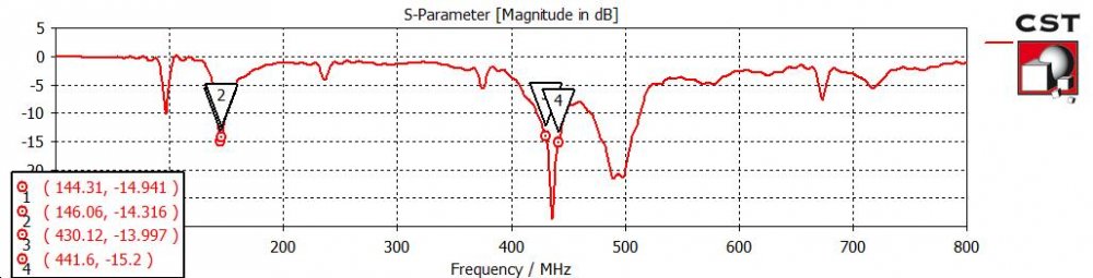

Yes,
I fix it;
5,5M  Meshcells,  lot of time to simulate...

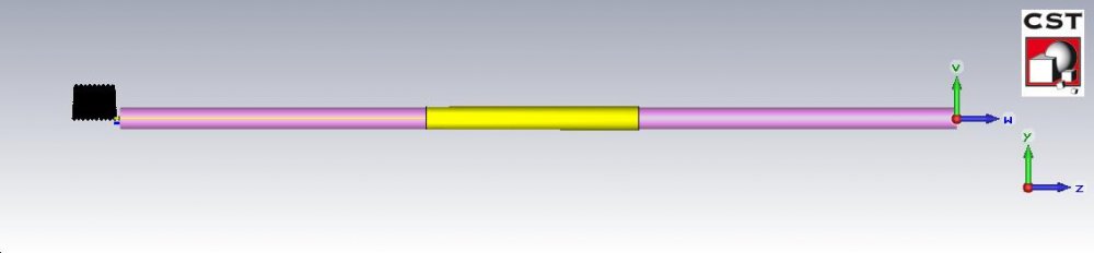

Well, but this antenna is not in reality ... the coaxial cable comes inside the tube...!!!
yes
must be so, the coaxial cable is inside a pvc 25mm conduit tube, anyway its effects are very low
Edited by Andrew77
I don't think so, however, it is important for the coaxial cable to be on the center of the spiral.
still try ...!!
Ah!
OK, I thought the spiral worked as a choke only...
I will try
