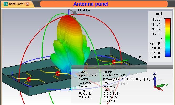

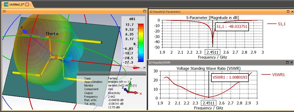

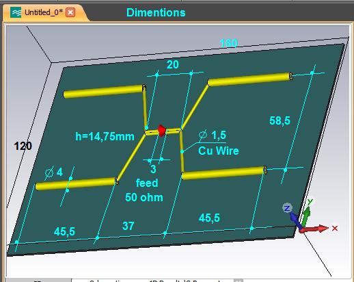

Lazy H Antennas
 An antenna array in which two or more dipoles are stacked one above the other to obtain greater directivity...

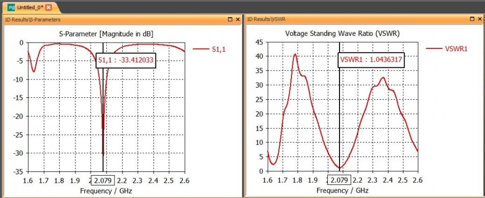

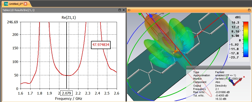

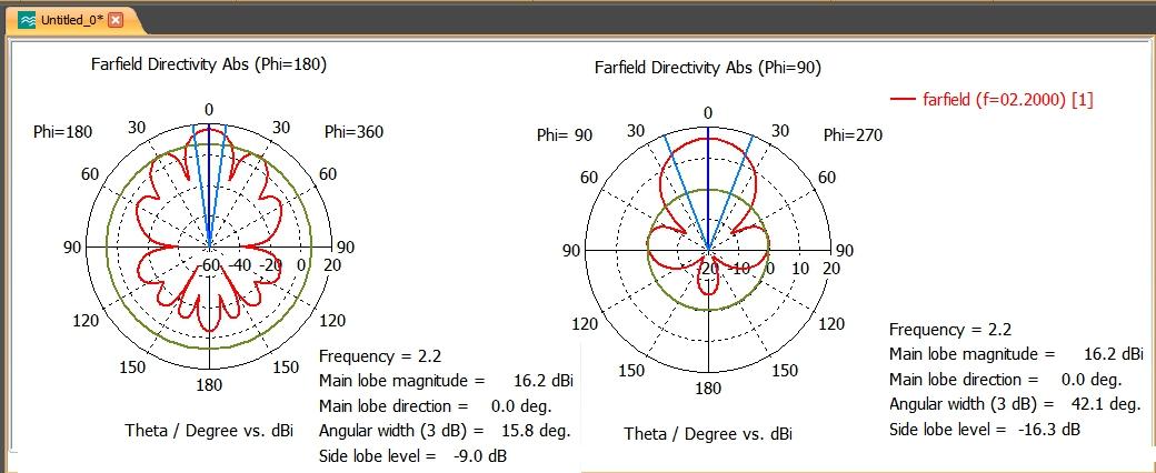

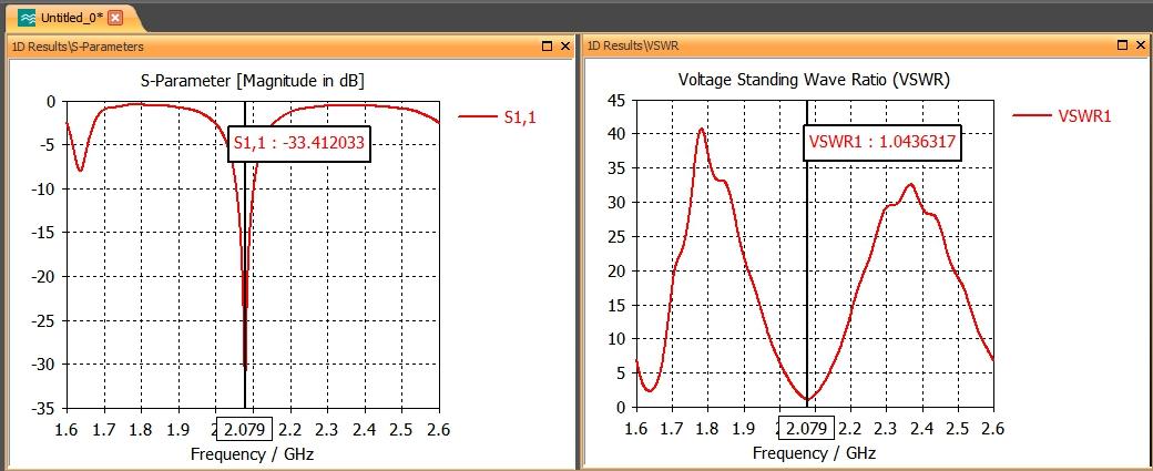

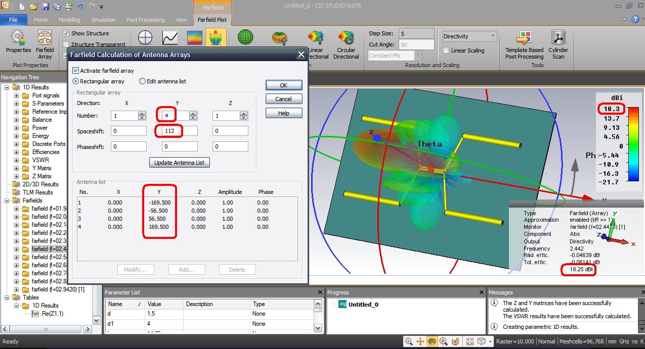

4 dipoles Lazy H panel antenna placed vertically ...
On 9/10/2016 at 1:28 AM, Admin said:
and how do you make the connection between the element?
