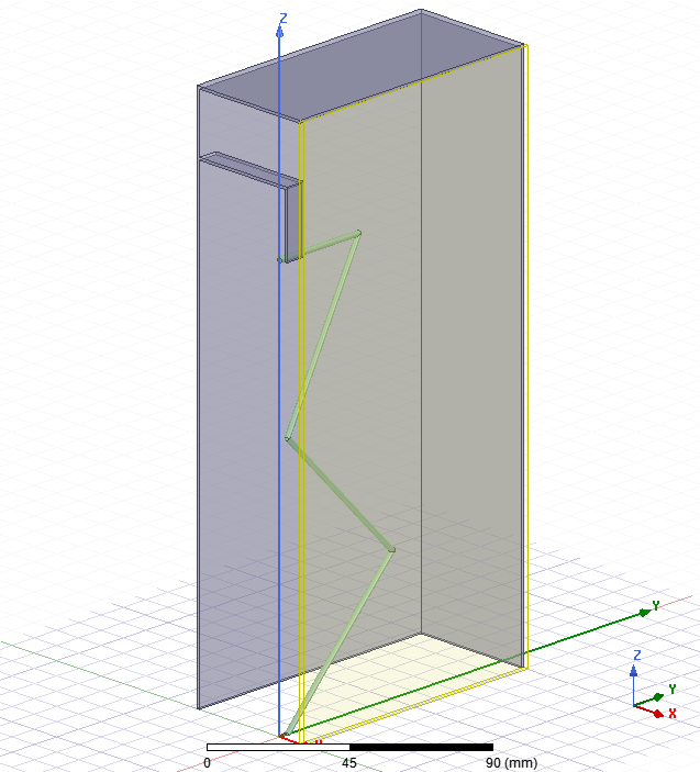

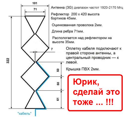

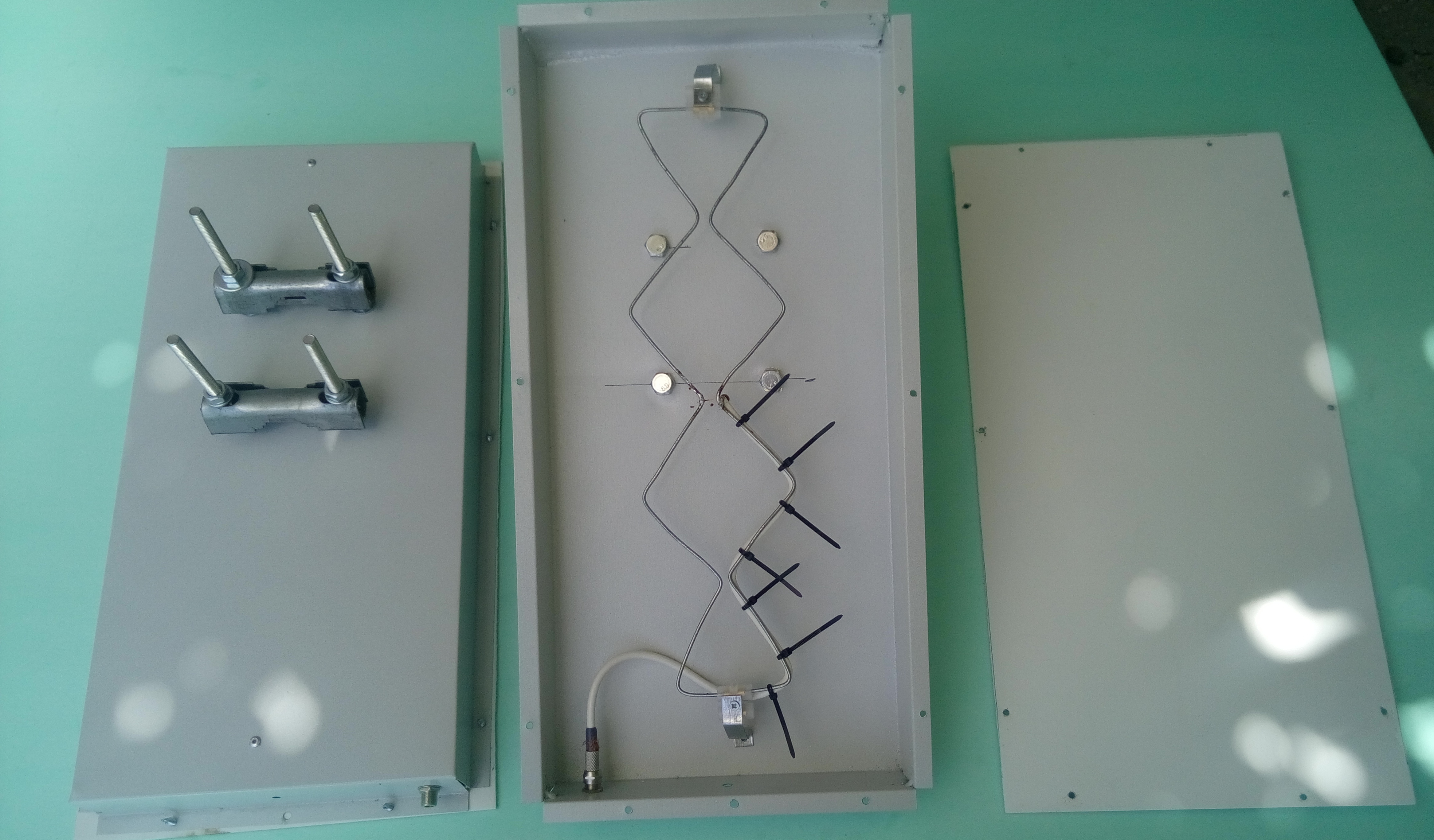

what is the wing size for this model?
wings=1x90x900mm
reflector-1,5x75x900mm
angle of opening = 19 ,,,, 33grd+90grd

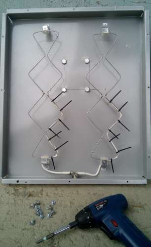

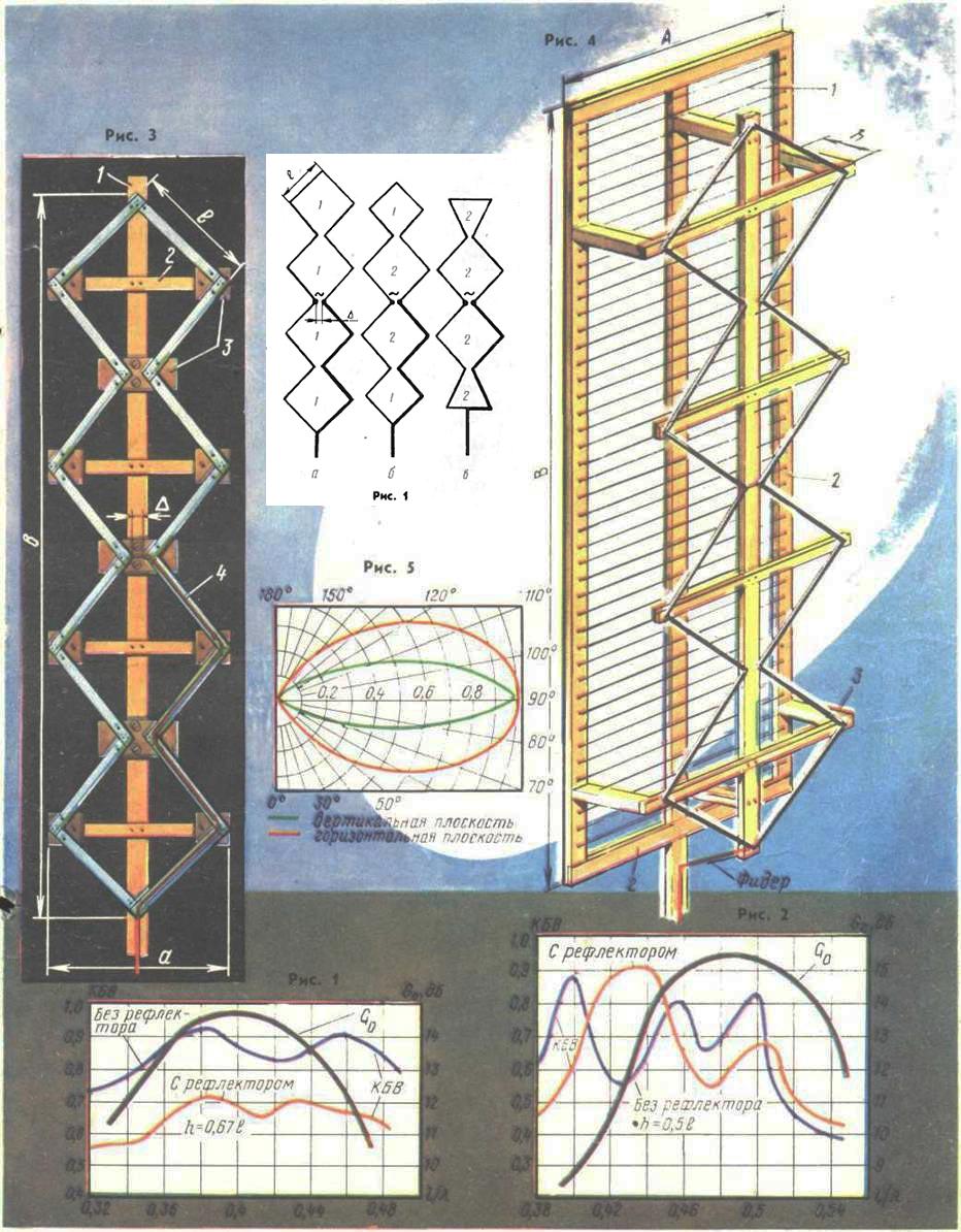

In this post, consider the common-mode lattice with simple food. The prototype is a design described in Radio magazine in 1979, number 7.
Bent-Wire Antena from http://4pda.ru/forum/index.php?showtopic=255989&st=3220

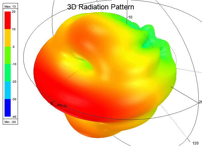

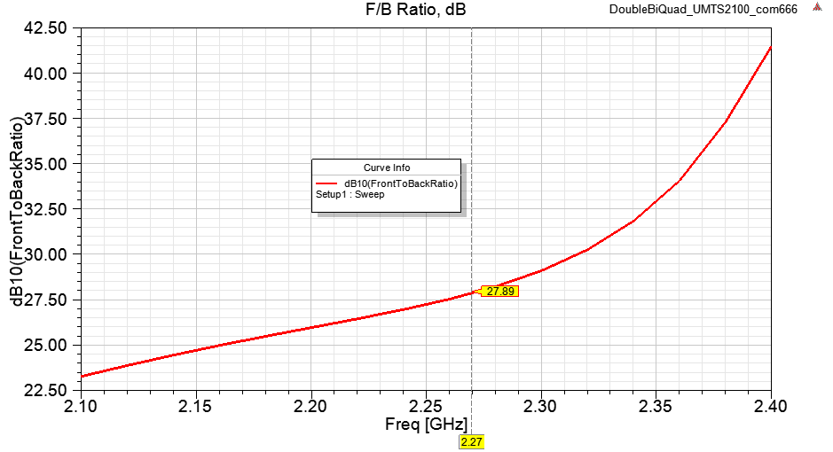

and this is a simulation done by Yurik82 user...
and a combination of two antennas,,,

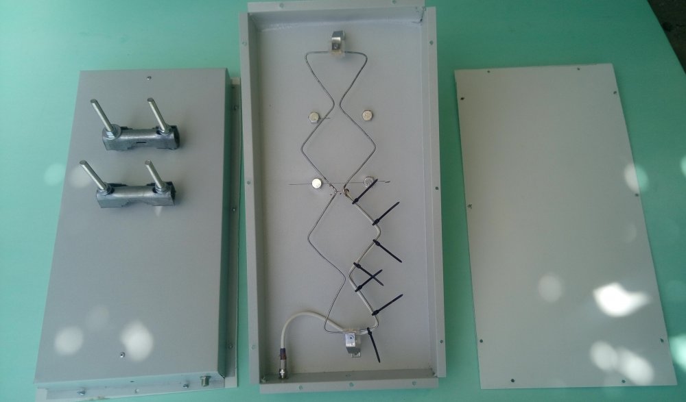

,,,after my tests, the best variant of the antenna of the bend-wire is this one...

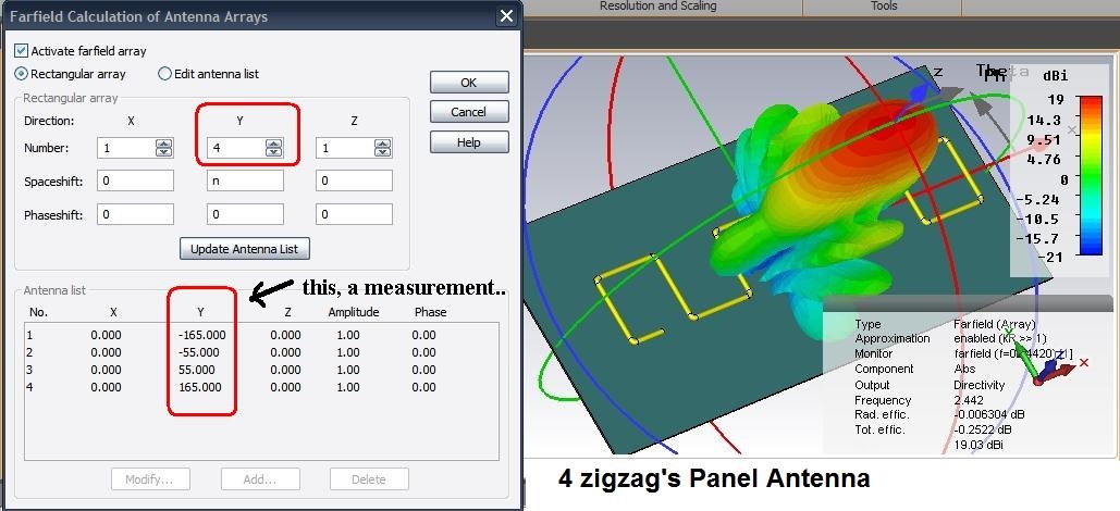

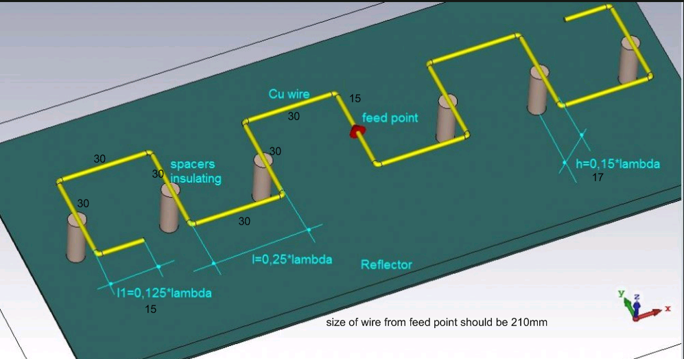

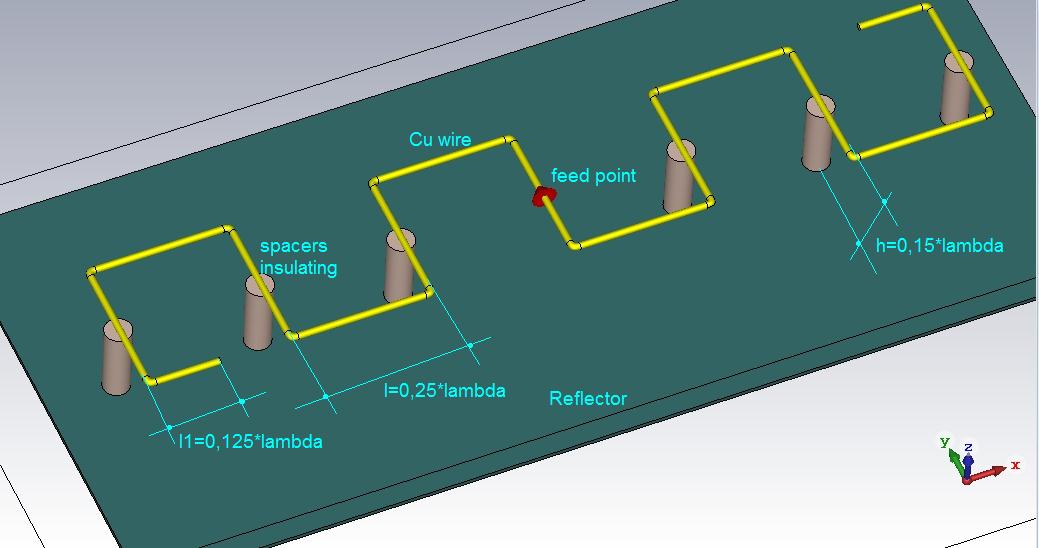

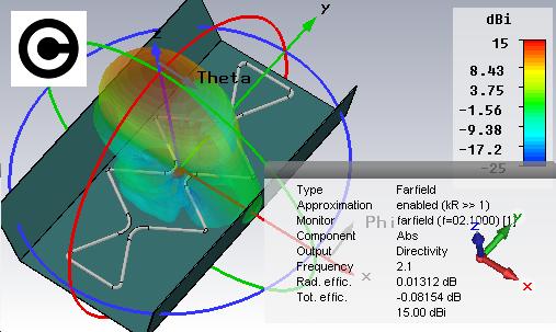

I have question about 4 zig-zag 2.4ghz antenna
How is possible that such a simple design have such a high gain >>19db ?
Please ..do you can show a measures of wiries for this antenna ?
thanks
Aurel
,,,zig-zag antenna is otherwise the type of the antenna...!!!!
Quote
he he ..i see
but what are the sizes of elements ?
or i can just use standard 1/4 lambda ...like in biquad?
if i catch some free time tomorrow i will try to build this one...
,,,for 4 zig-zag antenna are 19dBi ... ???
,,,yes it is in lambda / 4 (lambda / 8) ... I will resume this antenna with a new simulation because I have a new computer now...!!!
Quote
Yes for that antenna...
but something is strange about this shape , it looks that shape don't follow logic
of self-similar progression and that is still L/4 or L/8 length ?
Edited by aurel
Ok ...
I think the same ....
then if I am not wrong
size of Cu wire from feed point is 210 mm...right ?
so it is not wave x 2 _= 240 mm ?
