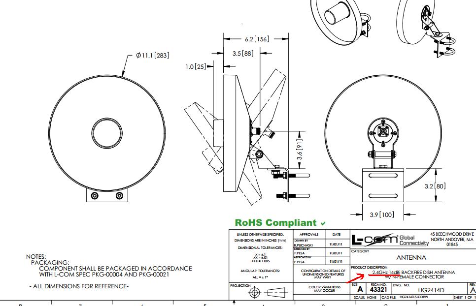

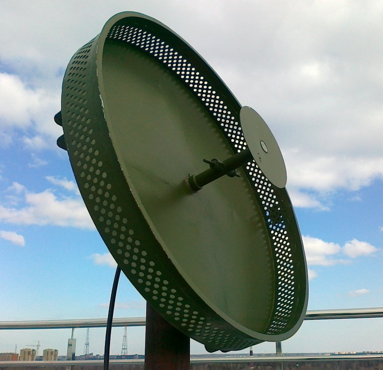

Backfire WiFi Antenna
Backfire Antenna is a very small antenna with extremely good gain. With a half power beamwidth of 32 degrees, the backfire is a highly directional 2.4 GHz antenna to put the signal exactly where you want it. The backfire is convenient because of its small size. The 17 dB of gain is incredible for an antenna this size. Installation is very simple with the included mounting bracket. The backfire is weather-proof because of it's ABS radome, which covers the radiating element.
If you have limited space but still need a high gain antenna, the Backfire is the perfect antenna for you WiFi installation. For full specifications, please see datasheet below.

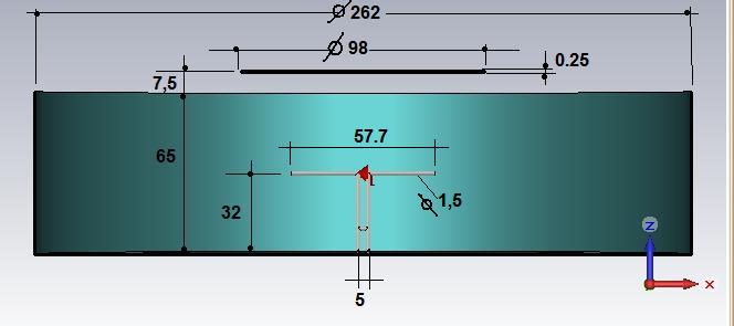

The backfire antenna principle is a highly effective technique for improving the pattern characteristics of an antenna. When the space between the reflectors(from 0.5 *lambda to lambda) the backfire antenna called short backfire antenna(SBFA) and its called long backfire antenna(LBFA) when the space between reflectors greater than the wave length (lambda ).

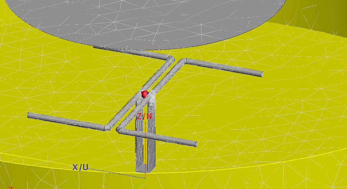

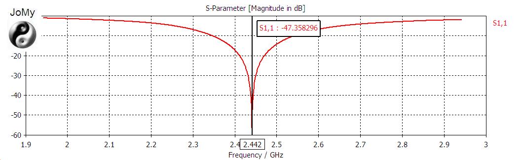

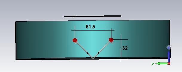

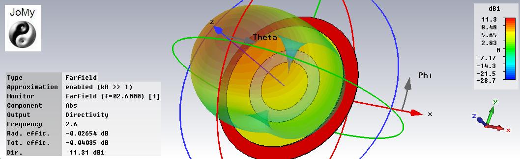

,,,it is a simple dipole short-circuited with an adaptation loop...!!!
,,,,yes,this is a combination of corrugated horn-antenna and short backfire antenna...!!!
,,,this it"s corrugated horn...

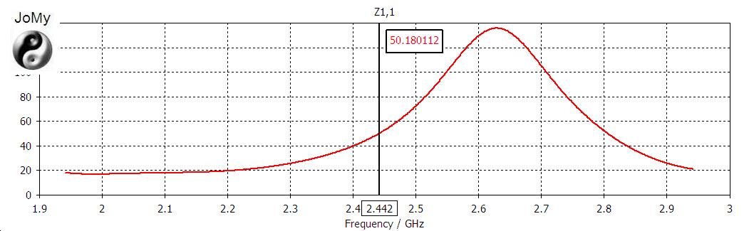

Jomy ,. which dipole PERFORMs better...?
did you try Circular Polarization...?

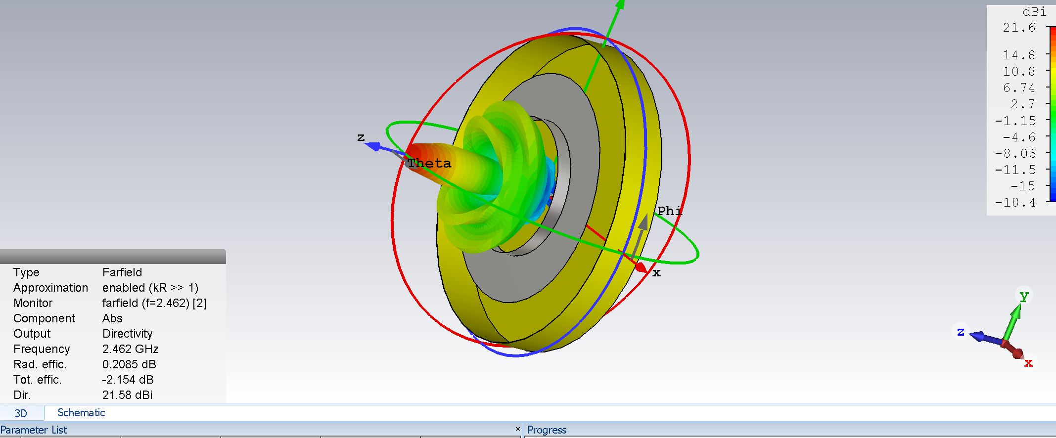

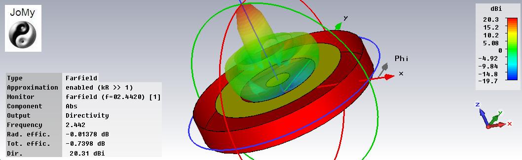

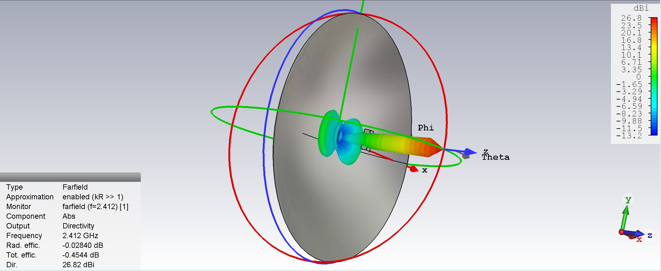

Look what happens when i add a RIM to the Secondary Reflector...
PD: What tool you use for CAPTURING the animation to GIF...? (for various frecuencies)
Clanon, you can create circular polarization by using cross dipoles. like crossed dipole or crossed bow tie antenna. moreover you can create CP by truncating stubing and sloting in a patch.You can get a circular polarisation with a planar spiral antenna which has the same circuit modelling of a dipole but with CP.
 For 2.4GHz sbf-antenna is very large in diameter(580mm)...!!!

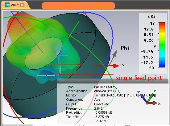

Admin, what is the aim of 2 dipoles, and 2 ports? Can it run with one?
,,,, yes, only one port can be run but the gain is smaller ... !!!

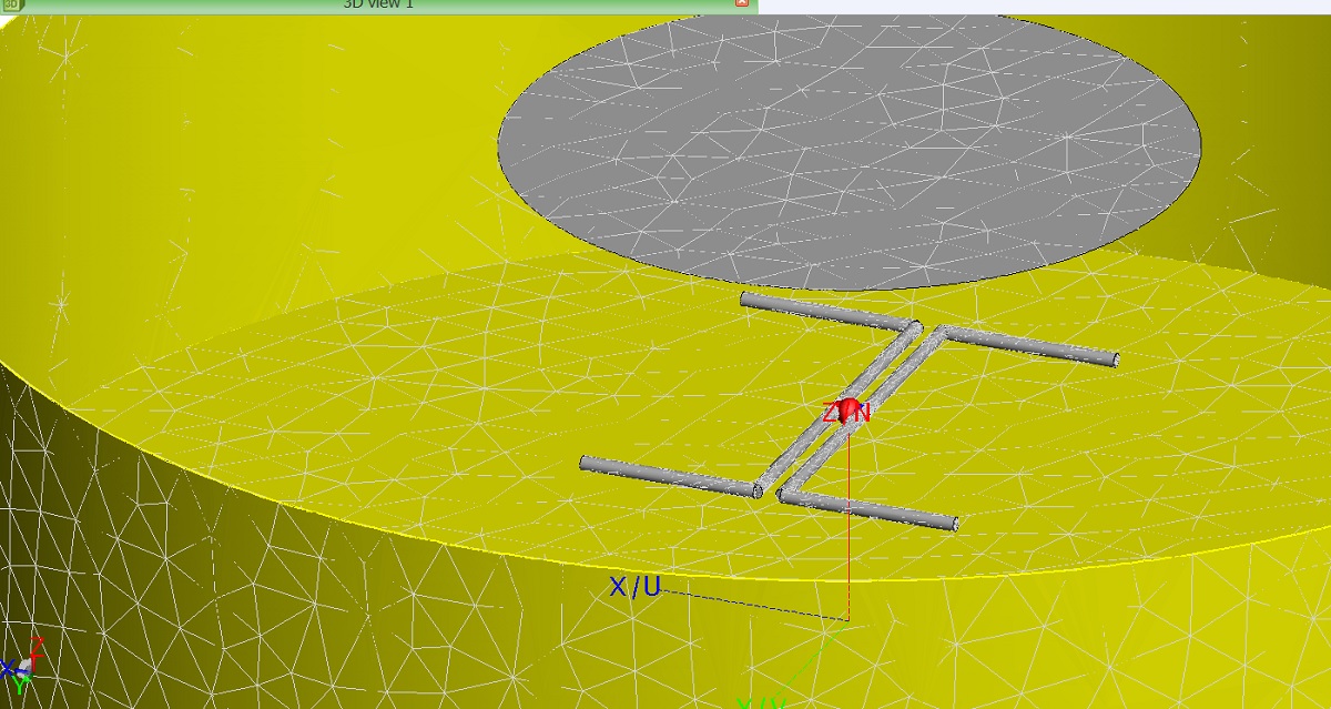

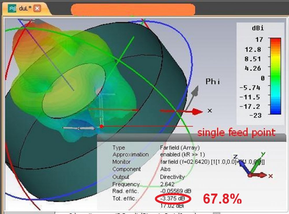

when i thinked about this antenna, it was single feed point in my imagination ))
so when 2 dipoles connected to 1 feed point it is gonna work like primitive array
which kind of connection for this dipoles?
there are options:

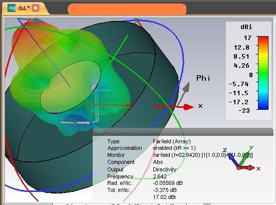

p.s. it looks +2db even if compare with commercially available 2.4 GHz backfire antenna same sizes
SO if you got SWR-meter and lot of free time - try to construct it :)
because this 2dipoles feed system is perfect for backfire antennas
...only 14 dbi...(there are LOTS of plannars with that and more...(smaller , size and volume...) Nice dipole though...to use on a bigger DISH
well, looks at the picture in first post. 17DBI - twice better
that is why i so surprised that no one still constructed it :)
The more dielectrics the more LOSSes...(efficiency is 65 % 70 at the best cases...) illumination losses , spillover...
These antennas...without VOLUME and Diameter...never pass the 17 18 dbi...and most are a BITCH to point out...(But good for a POINT to POINT)
PENCIL BEAM (hard to point it out)
there is no dielectric in this backfire antenna
only radome
and about 16-17dbi for such compact antenna...i am not sure and that is why i asked someone with SWR-meter build it and compare with reference 17dbi yagi or panel :)
this double dipole with single feed is PERFECT exactly for Backfire antennas...there is chance that this antenna in real life may perfome even better than _some_ simulators show.
but yes,16-17dbi is DEFFINATLY upper limit for this sizes
