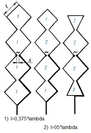

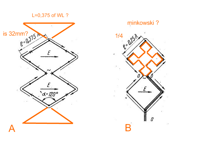

This design of double biquad i don't see yet anywhere?
Is dimensions the same as classic D-biquad or last outer element is 3x4cm i mean triangle sizes?

Is there a way to use minkowski fractal shape to build biquad ?
I would like to try it !

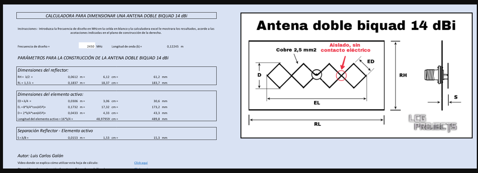

Hi Admin

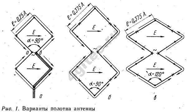

My first question is about image A - is size of element 32mm?
sorry i am not good with calculatioins..

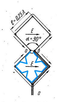

second question is about classic biquad 1/4 just with minkowski shape
on image B...
i hope that is possible?
thanks
Thanks ..so it is 46mm ..thanks
For image B i am not sure because this is some sort of koch fractal shape
but i see somewhere but like this:

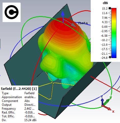

Admin, do you have other plots of this antenna, and sizes if possible?
 I will search the file and post the details....!!!

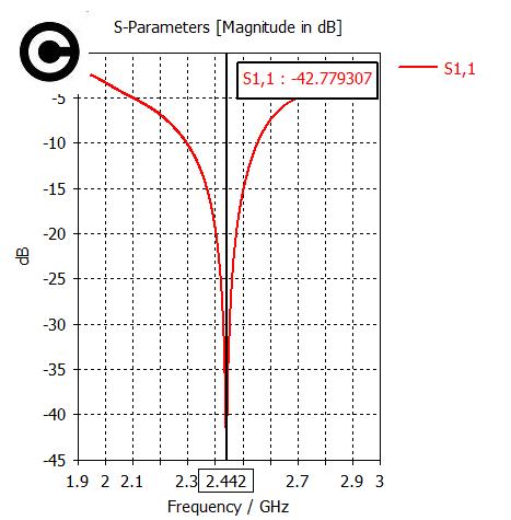

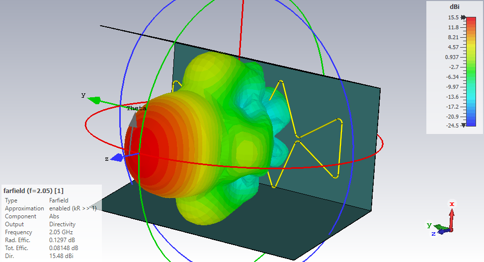

Thanks a lot, Admin, but it's 2.4 GHz. May be you have sizes for 2.1 GHz? I know that it can be scaled, but still.

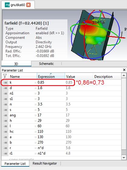

,,,you must only change the parameter "k" in the Parameter List...!!!
Now i see. It’s very kind of you, to give parametric model. I need to learn how to create models based on parameters.
Is it possible to make parametric polygons, Admin?
To which value should i change “k” parameter?
Edited by vodkaman

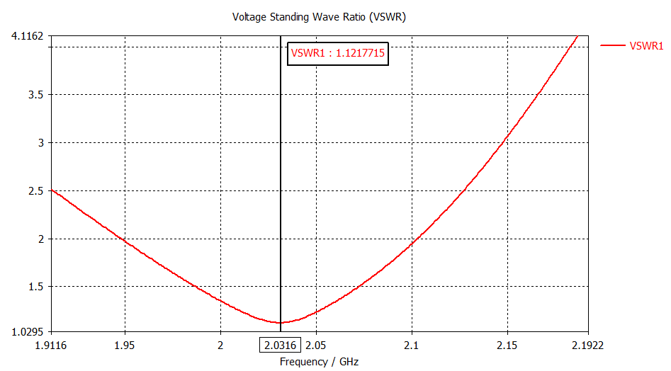

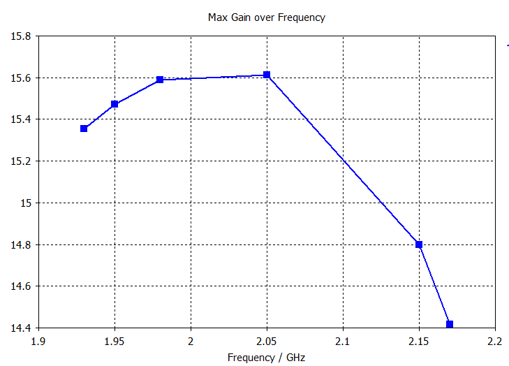

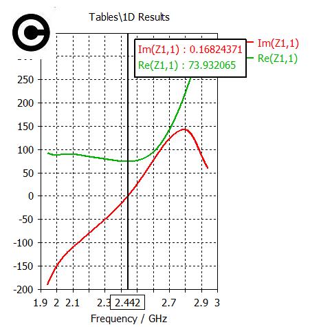

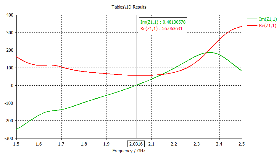

Here is what I've got for 50 Ohm:
Edited by vodkaman
Sorry, I don't know how to control size of the pictures.:(
Edited by vodkaman

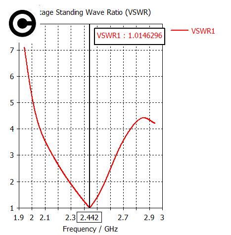

,,, gnutika antenna is for impedance of 75 ohms, if you want 50 ohms change the height "h" and the dimensions of the reflector....!!!
,,,and the coefficient "k" must be modified...!!!

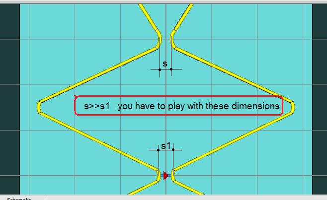

I wanted to check how broadband it is. And 50 Ohm can be obtained by narrowing the gap at feed point (in some limits).
