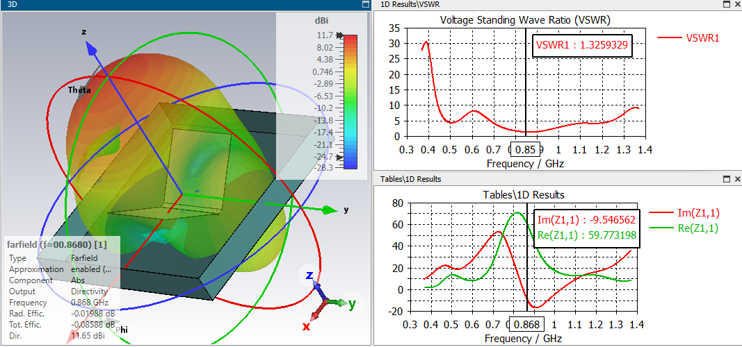

By the way, I am looking for a mechanically small and robust (panel ?) antenna (868MHz) with approx. 10 dBi gain, surrounded by steel on 5 sides.
Do you have any suggestions?
,,,what do you understand "surrounded by steel on 5 sides"...????
Reflector bent upwards on 4 sides to mechanically protect the inside of the antenna. I need a mechanically very robust antenna.

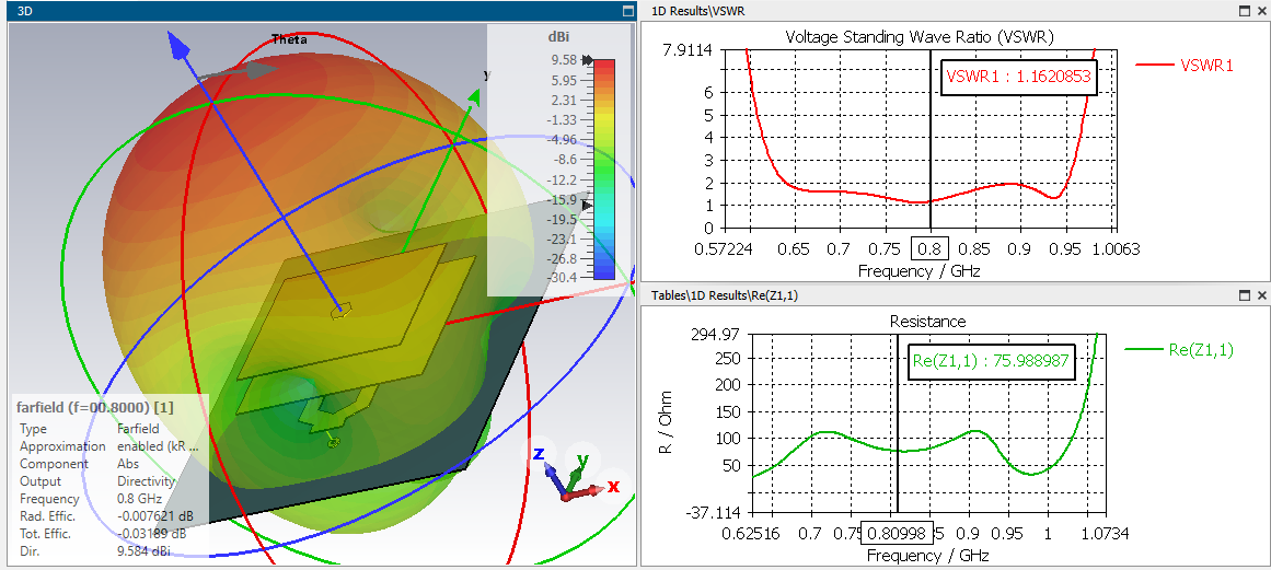

,,,then you don't want my type of antenna patch anymore...??
No no of course it would be very kind to receive the CST-file of your antenna from you.
exactly , thanks !!!!!
What would you suggest to make this antenna mechanically more robust?

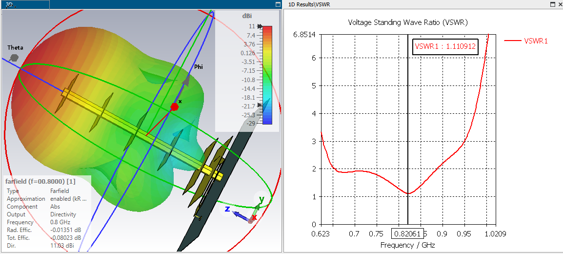

and one more director please!
and 50 Ohms possible ?
,,, okay, let's try...!!!
,,,should it be like that....???
,,, buddy, you know how to work with CST Studio...???
Something, but unfortunately I'm not that good and fast with it. I'm trying to learn.
I will try it with 2 directors, otherwise the antenna will be too long.
,,,it has a length of only 385 mm...!!!

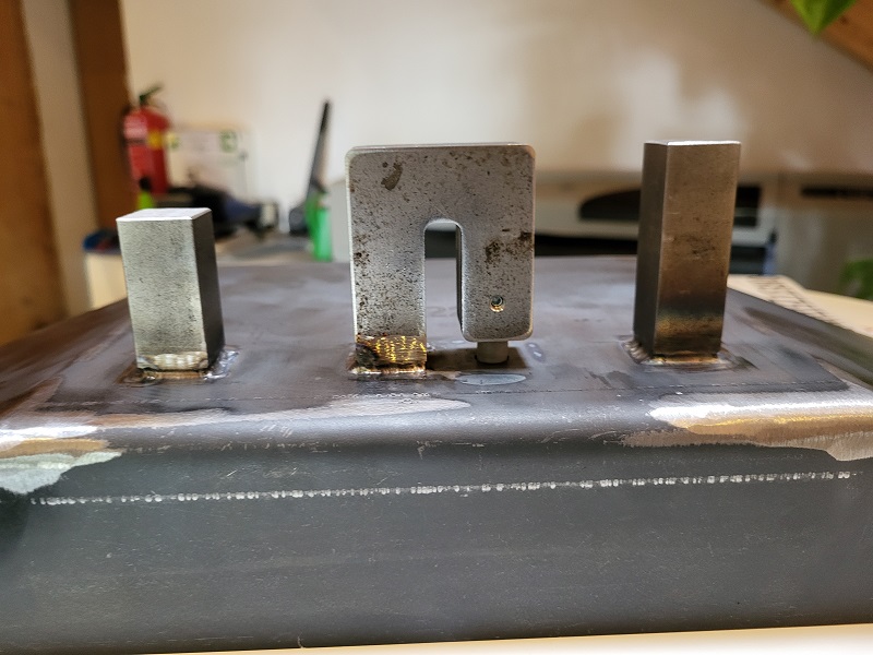

I have done this monopole Yagi. It's not prefect but working fine in industrial environment . It's made from 20 mm steel mounted on a metal construction with N-Connector underside and has to work in both directions. About 5.4dbi ,VSWR 1.06 ,  S11 -30.5. Maxium  nearly horizontal.
,,,which antenna are you referring to...!!!!

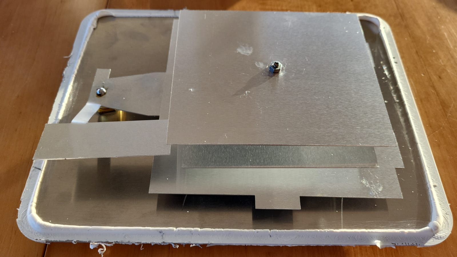

In the meantime I'm trying to "ruggidize" your BiQuad a bit.
Vova0,77.cst
