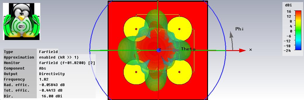

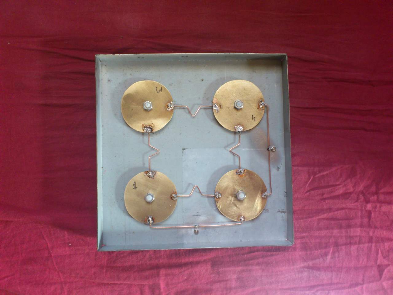

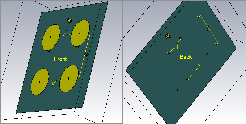

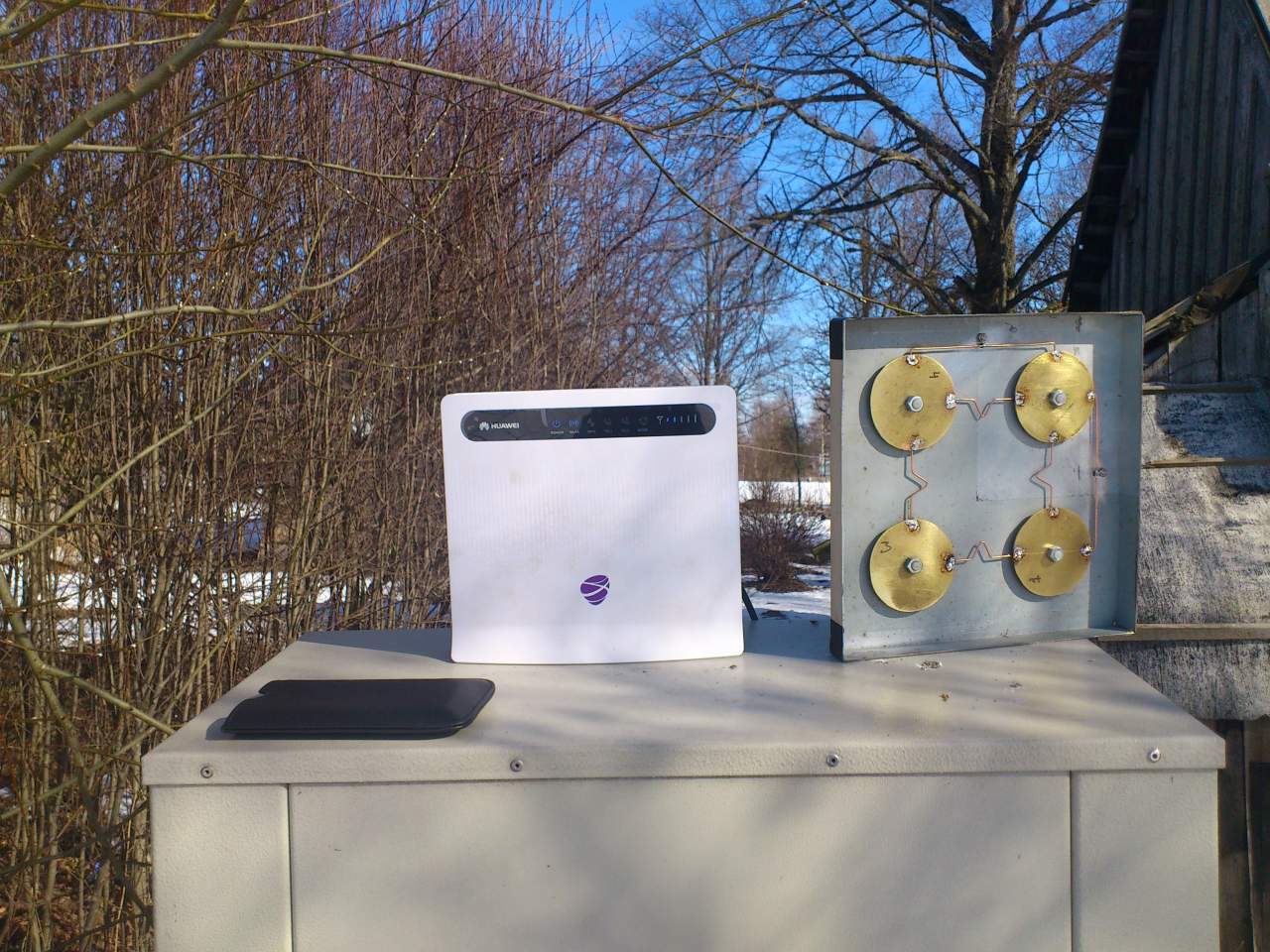

Below is a 2x2 MIMO antenna panel on 1800 MHz

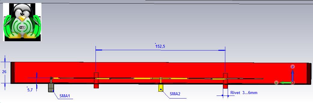

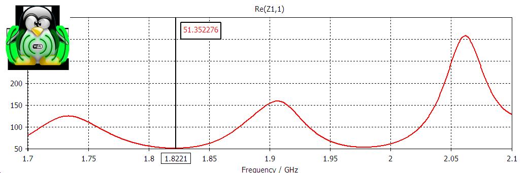

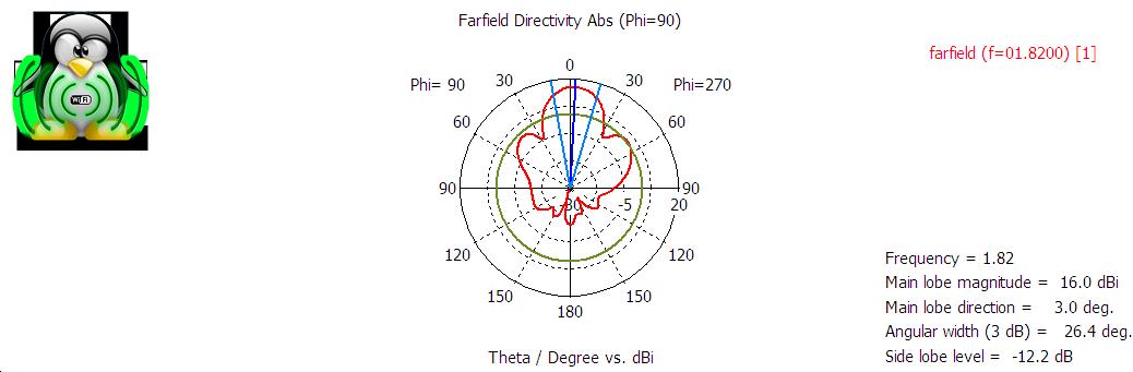

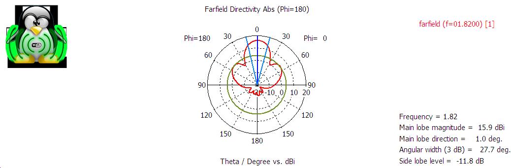

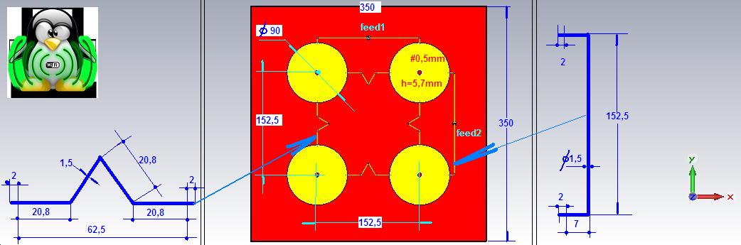

Looks nice .. so it works for LTE 1800 ? And the patch  connected or  isolated from the reflecter?
,,,it works...!!!
,,,the patches are not isolated..!!!

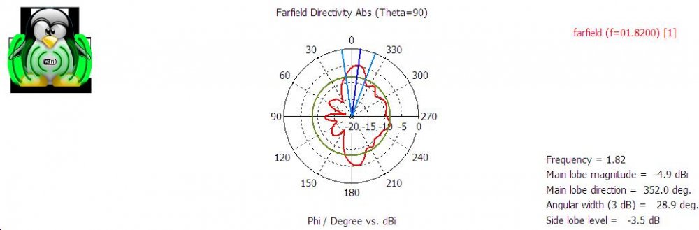

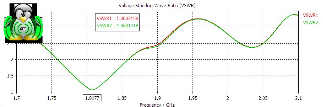

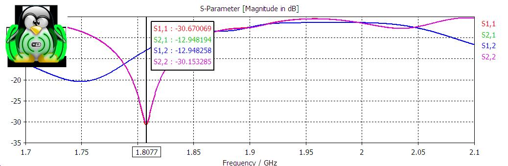

its not good antenna pratically   i had made it before it needs optimisation to cover the entire band of 4g lte  and goves high isolation of 2 ports !   may  mister jomy improve it !!
,,, I think that for a good isolation between ports, such a configuration would be necessary...
