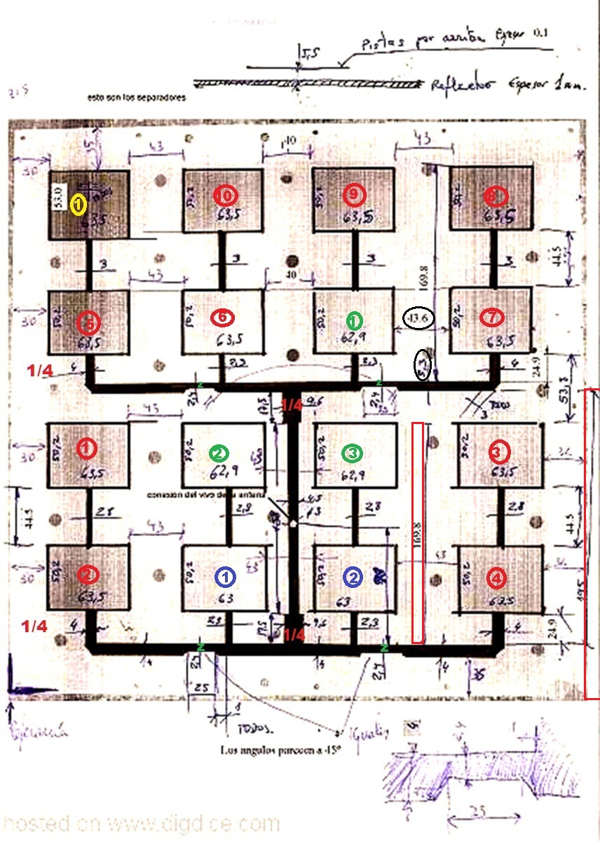

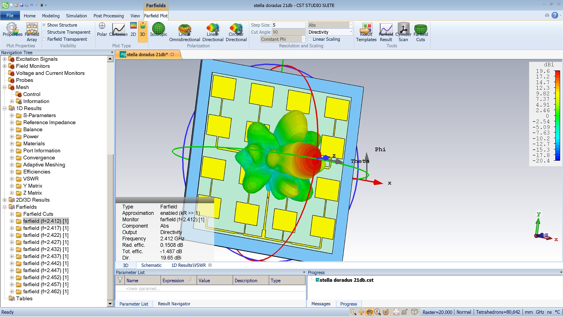

"Yes, I know this antenna, but it also puts the image whith  sizes..!!!

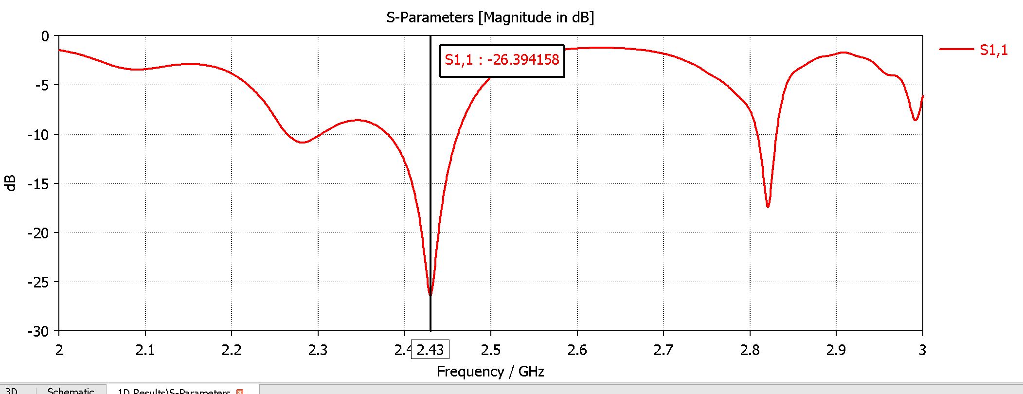

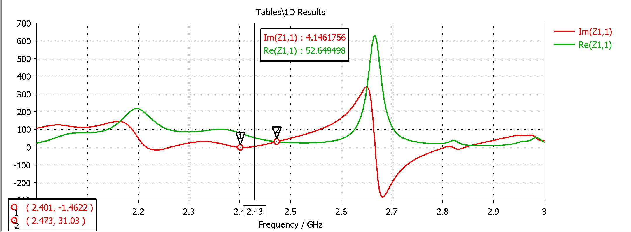

PS: Some doubt about PTFE thickness...I used 1.575mm...

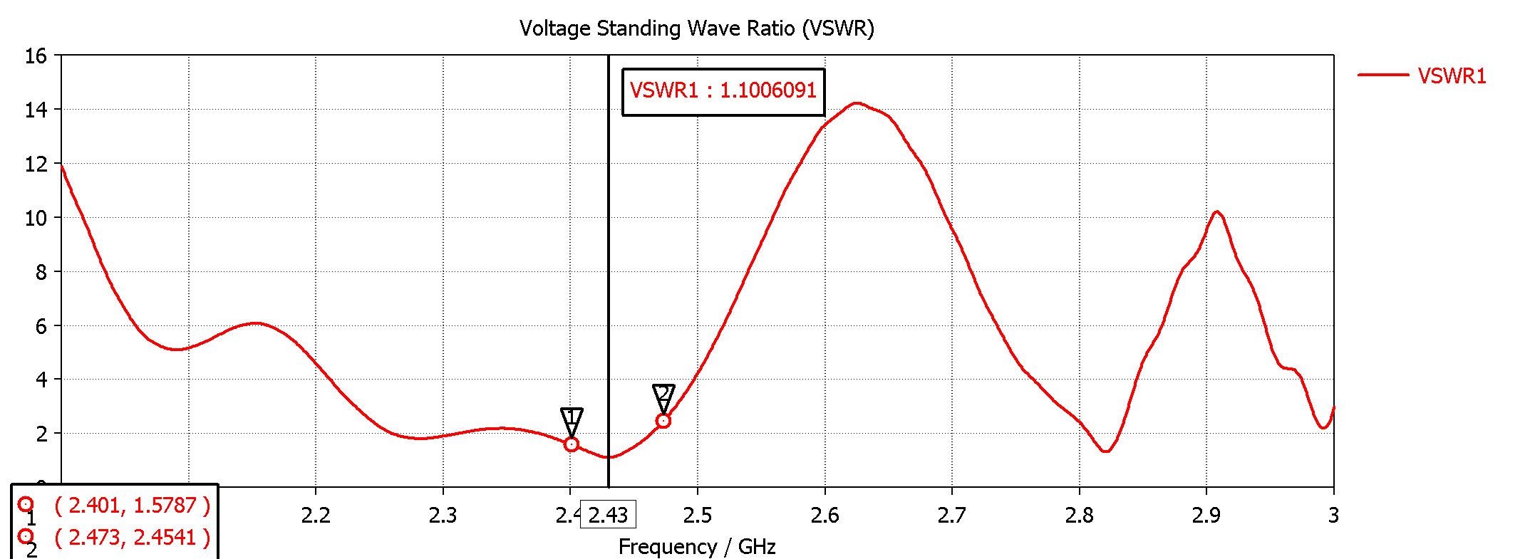

Jomy...impedance is close to 76ohms...what you think...reflector distance wrong ...? (i guess) (i used 5.5mm from backplane to PTFE)
,,,try 4,5mm  PCB-reflector distance and 0,8mm PCB-thickness....!!!!

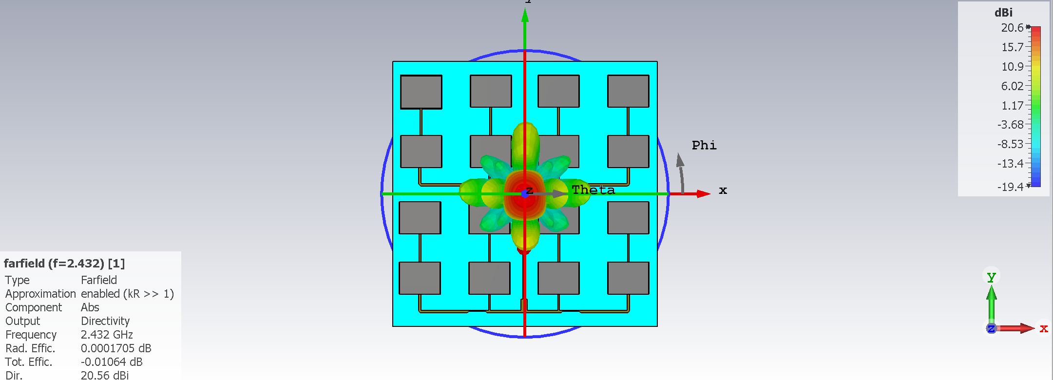

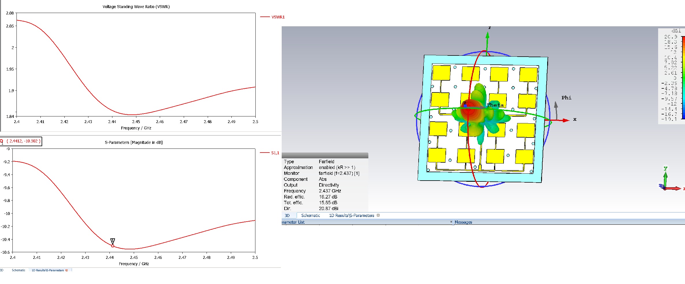

Getting 20.9dbi ALL wideband...BUT...Efficiency i low...
with waveguide port...
gonna try next with DISCRETE Port...
PS:the HOLES make a lot of difference in the PTFE!

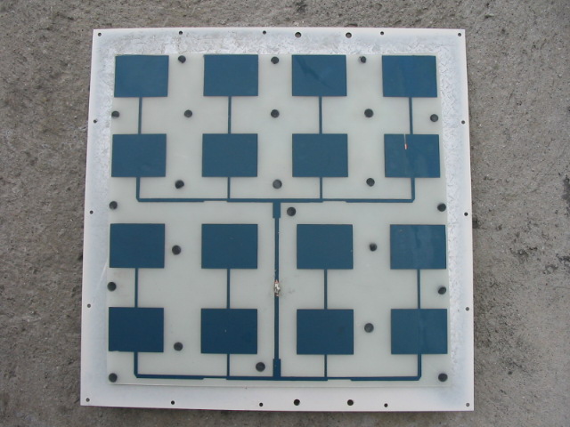

,,,for this antenna I think there are too many patches  to such gain in directivity ... ???
Modified for COPPER TAPE over PES (styrofoam)
