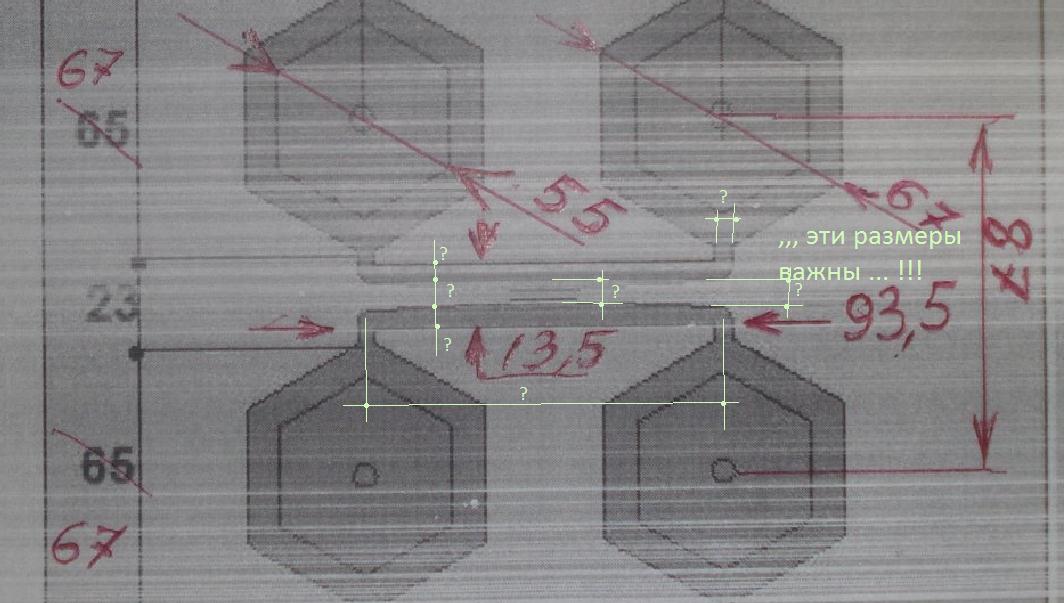

  Yes it is possible. This still needs to be done, but the problem is the power line. The flat antenna-15 has slightly different sizes, for example, the reflector has a size of 220 * 220. In addition, there is a slight difference inside. It was on the basis of this antenna that I made an attempt to connect the two antennas, the size and shape of the patches were slightly different. It's all about coordination, while there is not enough knowledge for this, I think you can help? Flat -15 is a bit modified by me. Something like that....:)
,,, the drawing above is made by me, approximately after Remo antenna...!!!
,,, if you have such an antenna, you can make some measurements and post them here....!!!

Я разместил его в галерее. Есть несколько изменений, извините за качество. За второй порт я буду рисовать мимо, художник от меня-не очень.
,,, I posted it in the gallery. There are a few changes, sorry for the quality. For the second port I will draw by, the artist from me is not very.
Well, let's see what we can do ... !!!
,,,хорошо, посмотрим что можно сделать ... !!
Под Нижним знаком вопроса-93,5 мм, размер между центрами заплат-90 мм
,, Under the Lower Question Mark is 93.5 mm, the size between the centers of the patches is 90 mm

Под Нижним знаком вопроса находится 93,5 мм, размер между центрами патчей составляет 90 мм, то есть 93,5 мм-это размер плеча. На следующем рисунке показаны изменения, остальное-в соответствии с вашим рисунком!
Under the Lower Question Mark is 93.5 mm, the size between the centers of the patches is 90 mm, that is, 93.5 mm is the size of the shoulder. The following figure shows the changes, the rest is according to your drawing!
Nickol, if you pick up two such antennas and give up the adaptive lines for port2 and also make the horizontal adjustment between them, you will get an antenna with a gain of 17dBi..

,,, Admin !!! Thank. Throughout our conversation, I mention the power line highlighted in blue. I do not know about this, so I asked you for help. It is also unknown what size antennas should be placed ???? !!
