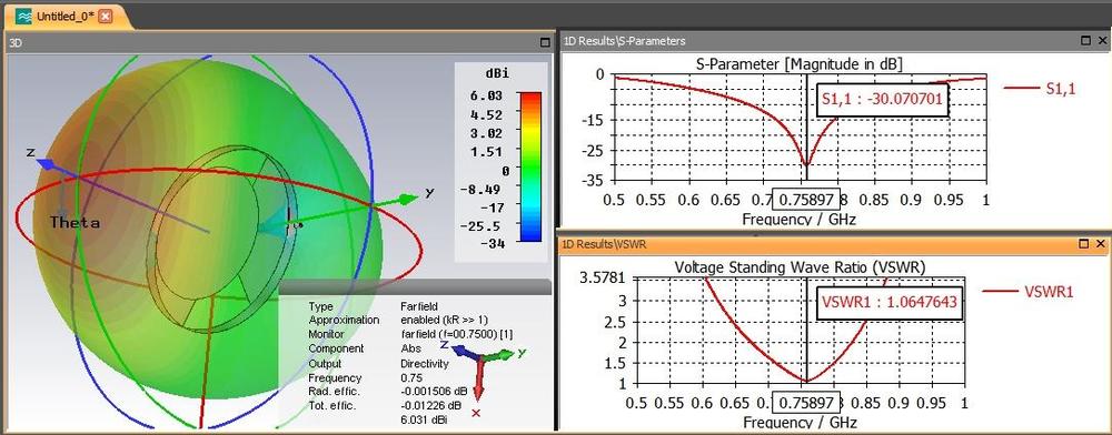

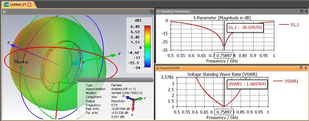

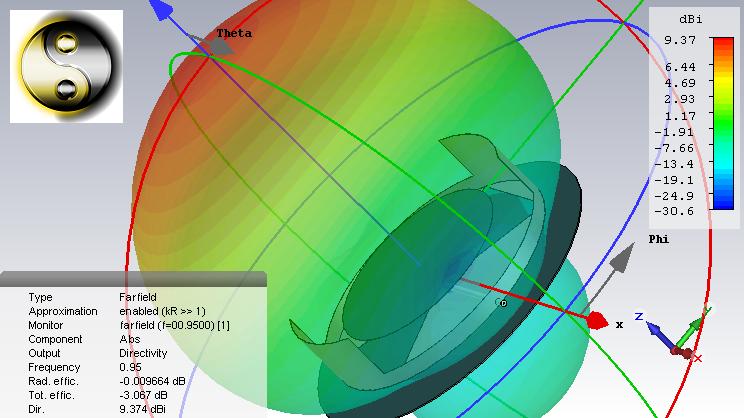

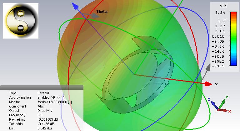

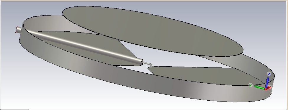

My proposal is to add a disk parasitic director
This solution increases the gain of antenna with 1.5 ---2 dBi
,,, and another improved by the addition of two lateral wings
,, but it is the most efficient solution by adding a reflector...
Could you publish the measurements please and how would it be with more directors? adding more directors
what would be the maximum profit
