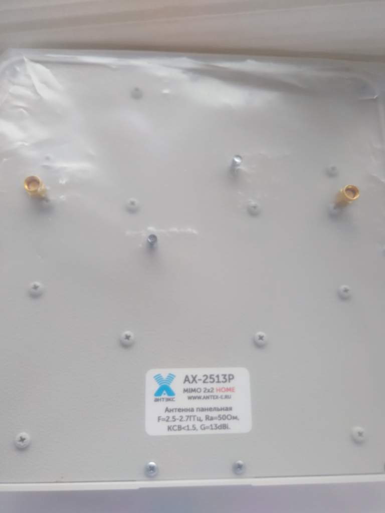

Panel antenna AX-2513PF 2x2 MIMO is intended for use in the set of user equipment wireless communication systems LTE, WIMAX 2.6 GHz band. AX-2513PF MIMO 2x2 antenna is the medium directional and recommended for application not far from the base station and in the city. Thanks to the support antenna MIMO 2x2, the speed of transmission when using modems LTE2600 (YOTA ONE, Huawei E392, Е3276, M100-4, etc) can reach 150MB/s.
For antenna AX-2513PF MIMO 2x2 is recommended to use cable with impedance of 75 Ohms. The antenna is provided with connectors f series

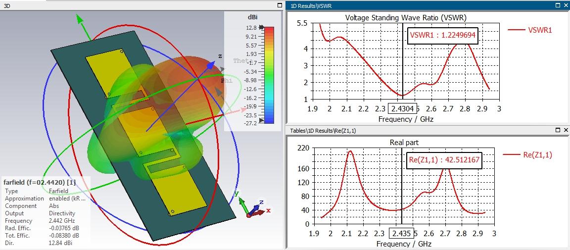

,,, so look for the 2.4GHz frequency...

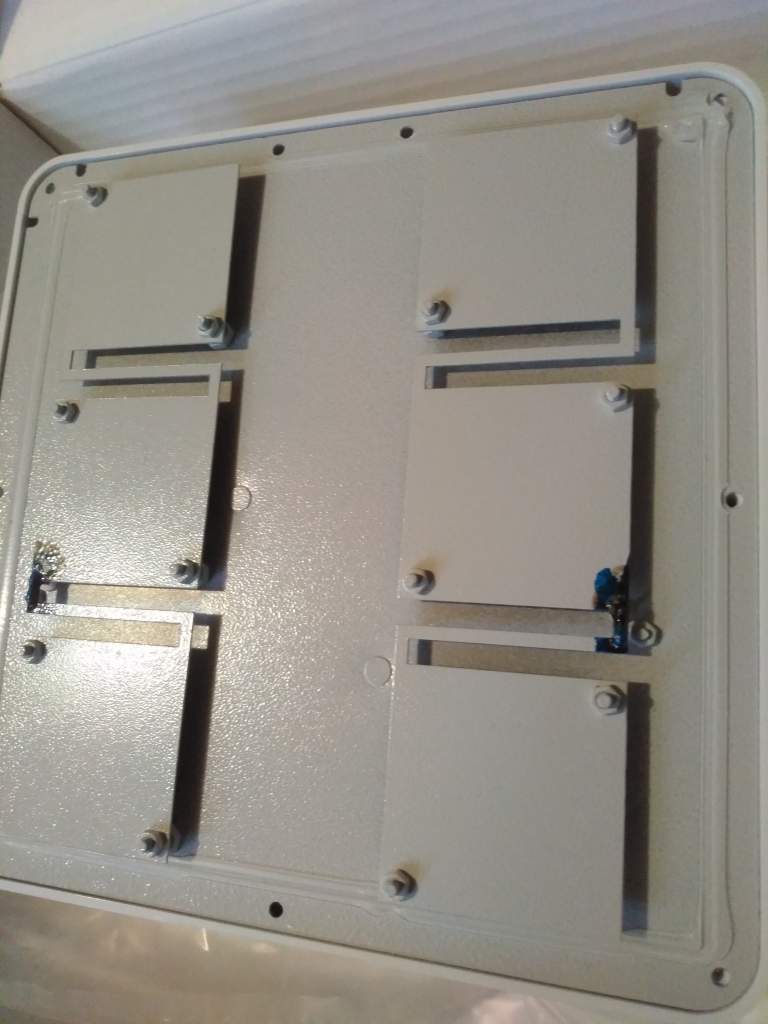

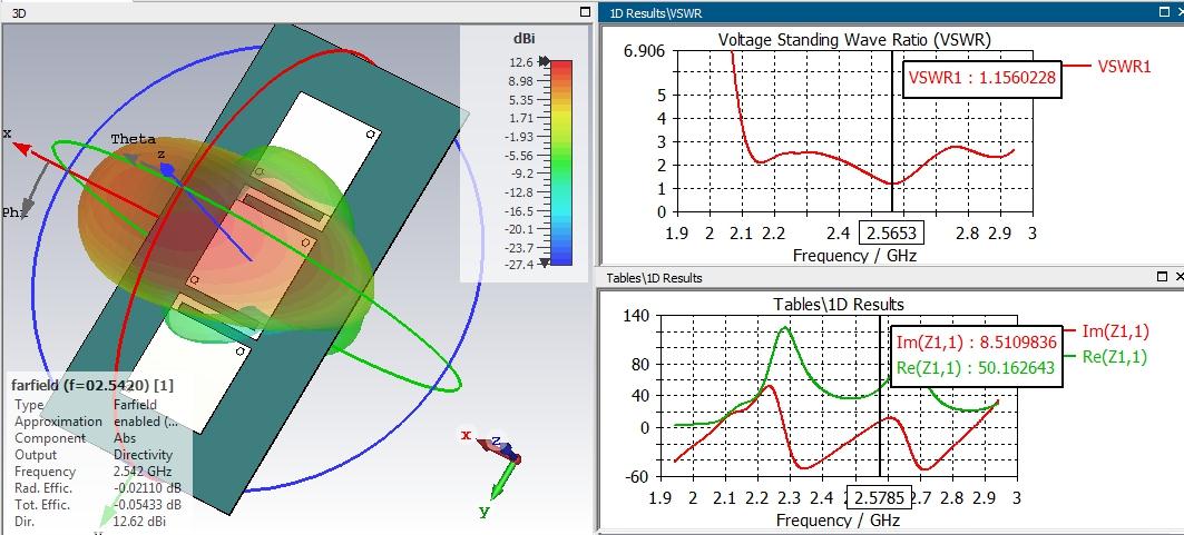

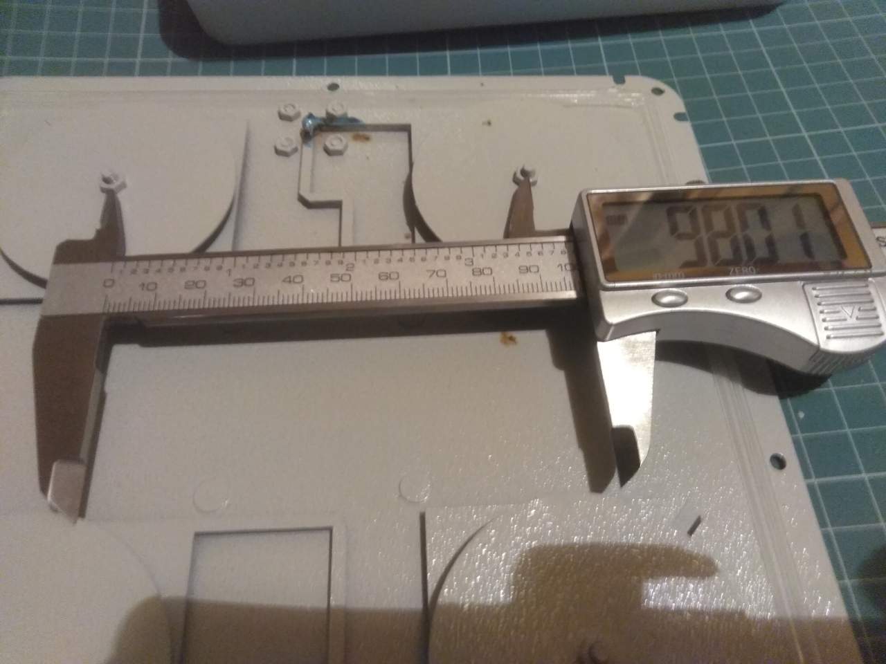

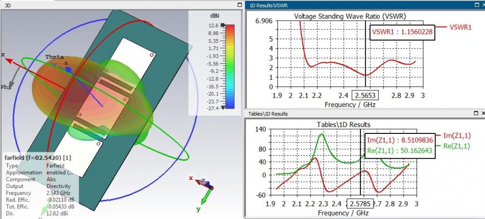

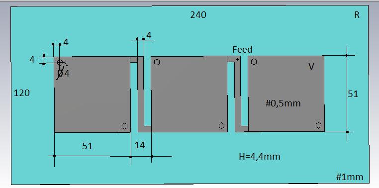

Nice series patch...Measurements...? (or .cst...)

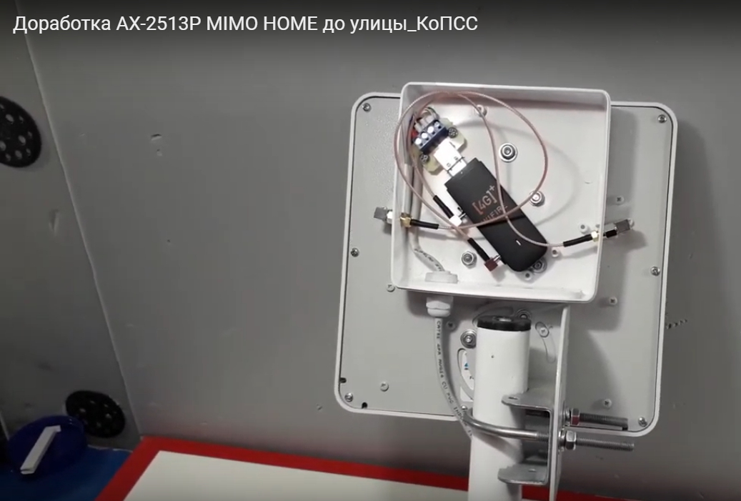

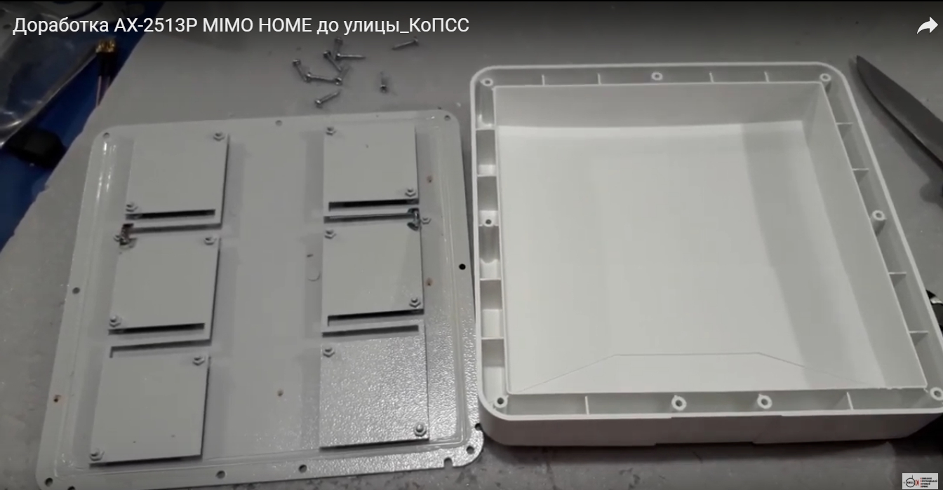

,,,and a mimo antenna construction with modem for installation outside the house...
