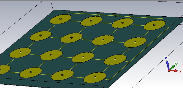

,,, the antenna I think would look like this, slightly modified...

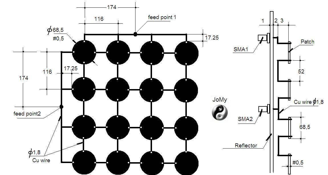

"I can do absolutely everything, but okromya hours," - so we have a village carpenters say. "Why, okromya?" “There’s nowhere to turn around with an ax!” So for me, an ax would need a good blueprint with size
and this picture is just beautiful, but uninformative

Good health, JoMY! How is work progressing on Panel 20 MIMO on round patches? I look forward to the final results in real sizes to make a working sample.
,,,hi buddy..!!!
I didn't make much progress with this antenna, but I will be ready soon..!!!
I try to see if the lids from the liver pate boxes can be used...!!!
Привет, Джомми! Я понимаю, что этот проект засунут в антресоли, а жаль. Я накопил кучу банок всех видов, пришло время открыть промышленное производство этого типа антенны. Мог бы взять свою долю ...
,,, Hello Jommy! I understand that this project is stuck in the mezzanine, which is a pity. I have accumulated a bunch of cans of all kinds, it's time to open the industrial production of this type of antenna. I could take my share ...
